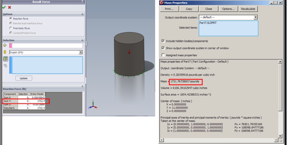

I have simplified my issue with a very simple problem.
Part = a solid cylinder with A36 [default] defined [1731.767 lb]
Simulation
Material - same as part material
Force = Gravity - 386.22 in/s^2 [default]
Restraint = Fixed on Bottom face of cylinder
Mesh - very refined.
Reaction forces in y - direction = [1732.4 lb]
I know that the weight is not much different in this problem - but it is a hugh problem in my simulation analysis - I can give more details on my bigger issue - but first I need to know why these weights are different.

I guess my Gravity Needs to be [386.08848 in/s^2].  I am still having COG problems, but will explain more in my next post.

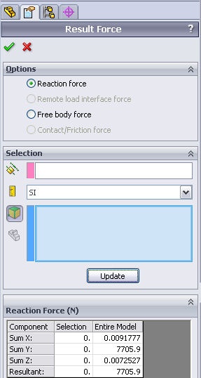

Pound is not a mass, thus gravity is screwing up your calculation.  Using SI units and a default mesh, SW Simulation got within 0.00024% of the mass calculated by SolidWorks (high precision). See attachments.
SolidWorks mass = 785.51669790 kg
SW Simulation mass = 7705.9 N / 9.81 m/s^2 = 785.51478084 kg
...up to 5 significant figures accurate, which is beyond the 4 sig figs given for the density.
This was done in SWS 2009 SP4.1.
