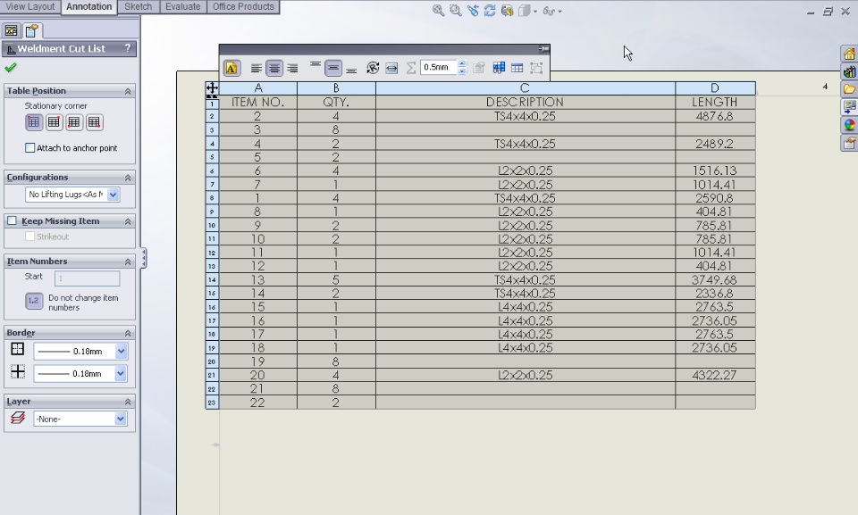

Is it possible to re-order cut list items? When I start a drawing on a weldment and insert my cutlist i want to be able to put the items in a specific order for detailing purposes.

You can click on the left side of the row in the cutlist on the drawing and drag it
NC
NC 2009-09-11
yes you can but the item number goes with it. I want to drag and re-order them and keep the item numbers in tact
SF
SF 2009-09-11

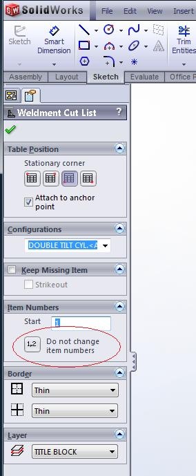

try changing the option in the cutlist properties to "Do not change item numbers"  it's under the item numbers title.

thats only for an assembly...i working on a weldment file

I have that option in a weldment drawing.

Lorne is correct, in the PM for the cutlist table, there is a section that is headed Item numbers. There is a small button labelled 1,2 click on this and the start option is greyed out.  This option seems to only work with the sort command and not the drag to reorder option.

It does not matter if the button is depressed or not, if I drag to reorder the items the items do not renumber.
