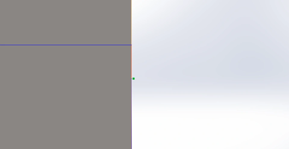

This is the part of the sketch before the fillet

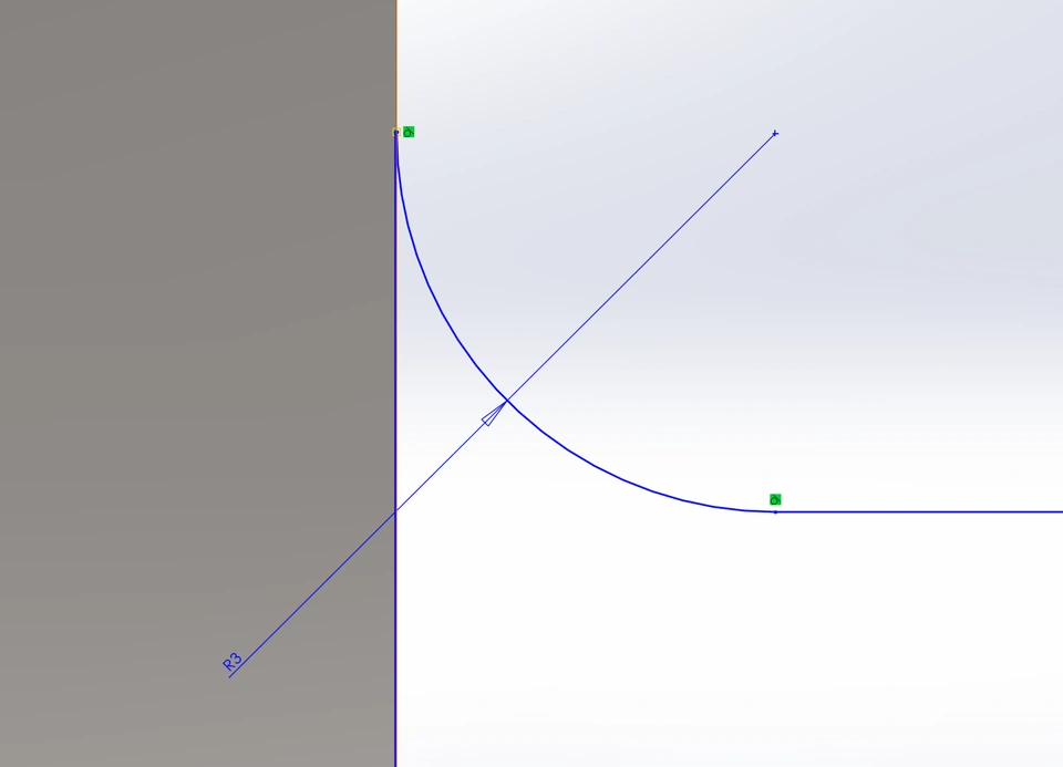

And after a 3mm radius fillet

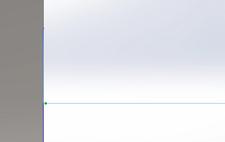

The problem area highlighted is a short gap between the edge of the curve and the adjoining line

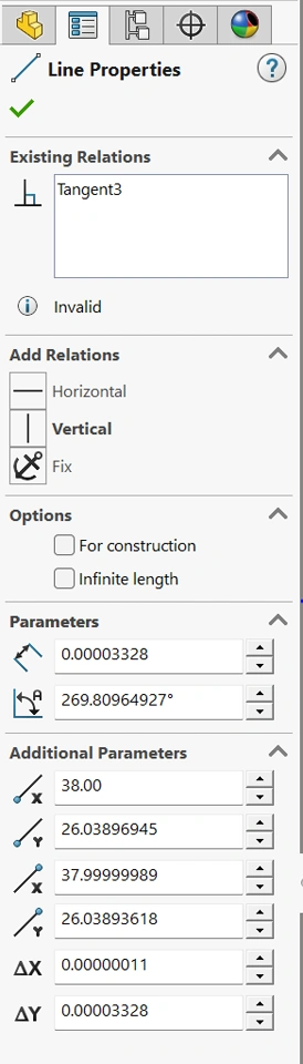

When selected, the following properties are displayed
In SW19, this gap does not appear and the sketch is defined correctly - what could be the cause here?
