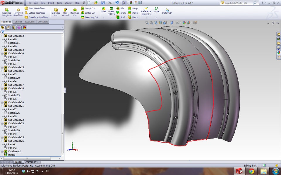

Hello everyone,
You've helped me a lot through this project of mine (school related), yet theres someting im rather stuck at for some time and i'm realy frustrated that I couldnt figure it out by myself.
I got this helmet model, and i want to cut its curved surface in a "radiation" cut, meaning the cut is perpendicular to the surface - as shows in the image marked in red.
Isnt there a way to sketch on a plane, split it on the helmet surface and cut it somehow?
The helmet file is also attached.
I would very much appreciate your help
Have a good day!
Sharon

RT 2012-05-14 Best Answer
Hi Shar ,
        Split the Bottom Face according to your drawing,Offset it by 0mm and do a thicken cut.
*_you may have to fill internal holes before doing the cut.
Regards
Ravi T

hi ravi,
thank you so much for the reply, i dont know why but solidworks wont let me cut the round parts. Could you attach the file you worked on?
Thanks,
Sharon

Hi again Ravi,
As you can see im stuck trying to cut the round solid parts (image below), can you help?
I saw that you made it pretty easy without special problems in your sketch

Sharon,
I think the trick is that you need to cut both directions. I'm not sure how easy that is to do. Another option would be to thicken your 0 offset surface both directions and then use Combine/Subtract.
Jerry Steiger
