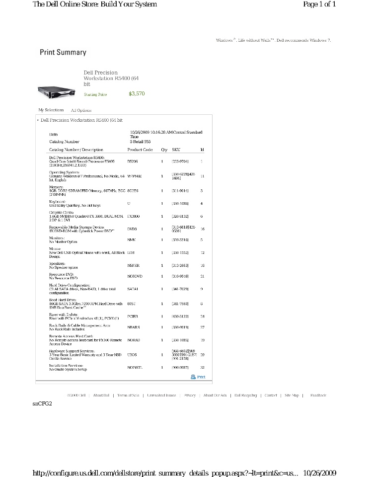

I am looking into changing the way our company is running so we can be more cost effective.  We have 60 Engineers/Designers/Draftsman that use SW and require workstations but instead of purchasing 60 workstations I thought about doing 10 rack workstations with a PC at each desk for running everyday tasks.  Does anyone have experience with this technology?  Currently two FEA guys here use this technology and have no problems.  After researching the internet and Dell's website it seems like a better idea for us.  What I was looking at is attached.SolidworksAdministration

I could be wrong, but I think the R5400/FX100 solution is for a single user.   Only one FX100 client can used with each workstation.  It would cost about $4800 for each user with a 3 GHz Core2 Quad processor, 8GB RAM and FX 1800 graphics.   That doesn't include the client monitor, keyboard or mouse.  It would cost far more to have 60 rackmount R5400s than 60 T3500 workstations - and the T3500s would be faster (Nehalem vs Core2 architecture).
Otherwise, the R5400/FX100 should work just fine with SolidWorks.    It's a great albeit expensive solution for engineers who work in hostile environments.

I understand what you are saying but we typically have 10 users running SolidWorks at any given time.  What I was thinking was a switch at each users desk so every engineer has access to the workstation but only uses it when they are running SolidWorks.  I find it pointless to have 60 workstations when typically only 10 people use them to their full potential.  We already have monitors, keyboards, mice etc. because everyone is already running SolidWorks on a machine, just not all on workstations.  We are currently using T3400's with Intel Core 2 Duo 2.66 GHz Processors, FX3500 cards, 4 GB of RAM...
