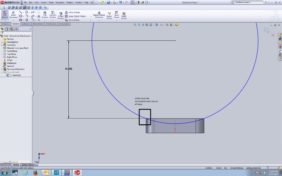

Hi All,
Quick sketching question.  I need to get the circle on attached sketch coincident with the corners of the rectangular tube while still maintaining the center / midpoint relationship between the two.  I can trig it out to get close but then when I go to cut extrude, I get some weird pieces still there.  Not sure what relationship to add at this location.  Thanks!

I would use a construction line from the origin to the circle centre for the vertical constraint, and use a Coincident constraint between the circle & a vertex.

Dave, I just made a coincident constraint to fully constrain your sketch and it looked fine. Are you seeing a gap at the corners when zoomed in real close?

I think I got it guys.  I made a point at the corner, then clicked on both the circle and that point and chose coincident.  Also to keep on center, just made the coincident there too.  Thanks for your responses!

Another method would be to place a sketch point on the circle, and use a coincident constraint that point to the edge.
