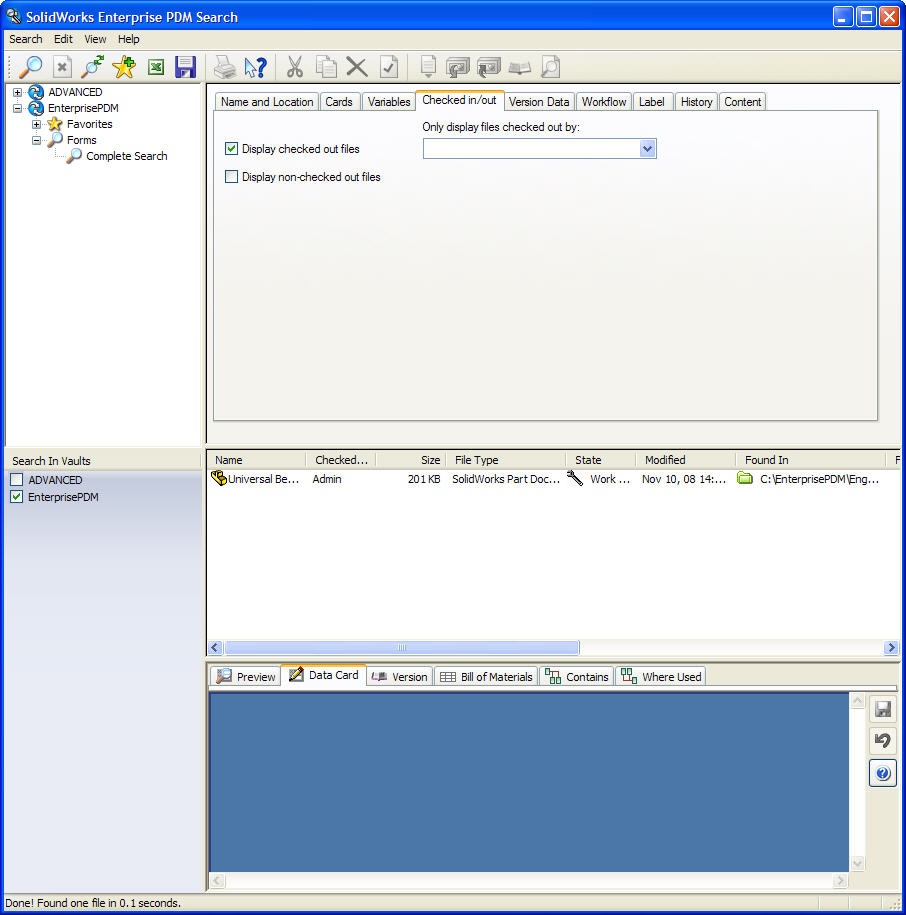

Hi,
I am trying to query our SQL Database in PDMWorks Enterprise to getinformation on files, specifically if they are checked in our out.I have no DB experience but have been looking at samples all aroundto see the basics. How would I get information on a file if it ischecked in or out? I want to use this in conjunction with thereport generator.
Thanks.SolidworksSolidworks Pdm enterprise Pdm

Michael -
You don't need to use a query. You can do it with a simple search.(see image)
Search the knowledge base for solution S-013369. It will describehow to create reports. You will need knowledge of T-SQL.

MD 2008-12-09
Michael,
For checked out (locked) files use this.
select filename from documents where len(lockpath) > 0 anddeleted = 0
For checked in files,
select filename from documents where len(lockpath) = 0 and deleted= 0
Be careful though, this can potentially return thousands ofrecords!
Mike

Michael -
You can't just put SQL queries in the enterprise report tool.Please look at the solution I refered you to earlier.
The report should look more like this:
@[CheckedOut]
§Name [List Checked out documents]
§Company [SolidWorks]
§Description
[This query lists all checked out documents document]
§Version [1.1]
§Arguments
§Sql
SELECT Documents.Filename AS [File Name], Users.Username AS[Checked Out By]
FROM Documents INNER JOIN
Users ON Documents.UserID = Users.UserID
Where Documents.Userid <> 1 AND Documents.Deleted <> 1
