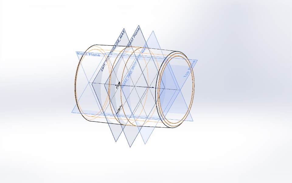

2. Items/Dimensions Vanishing
This problem seems to occur more frequently than I was orginally aware off, but I have engineers complaining about dimensions and items suddenly vanishing out of models, this issue does not only occur in .sldasm files but in .sldprt as well.  Below are two different images.  One complete, and one with th a missing latch, you can see it's still being reference.  It's not only parts within assemblies that go missing but dimensions as well.
File with Latch
File Without Latch

for item 2,
those appear to be scanned in print outs. do you know how they we printed? (i.e. one from SW and the other from the preview pane) we have similar issues occasionally where some model edges do not show up in the preview pane, and therefore do not print when printed from the preview. this is related to the views not being fully regened when the file was last saved/checked in.

Hi Jeremy
These are screen shots of PDF's that they had printed out. I had scanned their PDF's and emailed them to myself and could not break them up or re-save as JPGs, hence the screen shot.
Let me take your answer back to them and see what they have to say.
