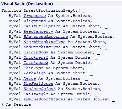

Hi everybody,
My name is Christian and this is going to be my first post here. I tried searching the forum for this subject, found nothing so here comes my question.
I am trying to understand the API function InsertProtrusionSwept3  and it goes ok, however I have no idea what "Propagate" means. I tried to model some sweeps with the recorder on to see if changes that I made would change the value from False to True, however no succes. Is there someone who could explain to me what this variable does?
Thanks in advance, Christian

CA 2021-04-08 Best Answer
2018 SOLIDWORKS API Help - InsertProtrusionSwept3 Method (IFeatureManager)
API Help lists:
Propagate
      True propagates the swept protrusion to the next tangent edge, false does not
CB
CB 2021-04-08
Thanks for the reply. Could you give me an example where the difference is shown/explained? A lot of times the API Help description is quite difficult to understand so I just play around with recordings to see if altering parameters in features changes the code, so I know what a the influence of a variable is. A lot of times this approach of learning API works but not this time.
