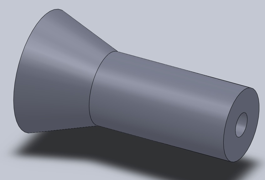

Another quick question.  Following along with the Essentials training book, I'm stumbling on a certain lesson.  For the tool post attached, I cannot figure out how to place the spherical radius on the end (R45 spherical radius per attached PDF) and also the flattened surface at 32mm wide.  I know this is certainly a simple one for all of you experts on this forum lol.  The square cutout is easy as an extruded cut through all, but I need to get the flat surface first before I can place the cutout at the tangent point at the left end for positioning.  Much appreciated!  Thanks!

you can add the radius to your orininal sketch.
then cut the flats  like this
comment imagecomment imagecomment imagecomment image
