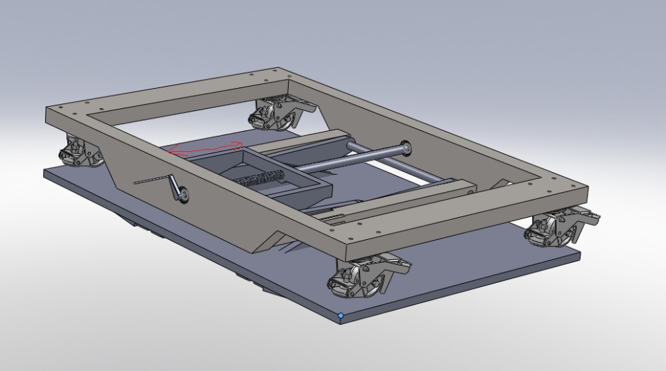

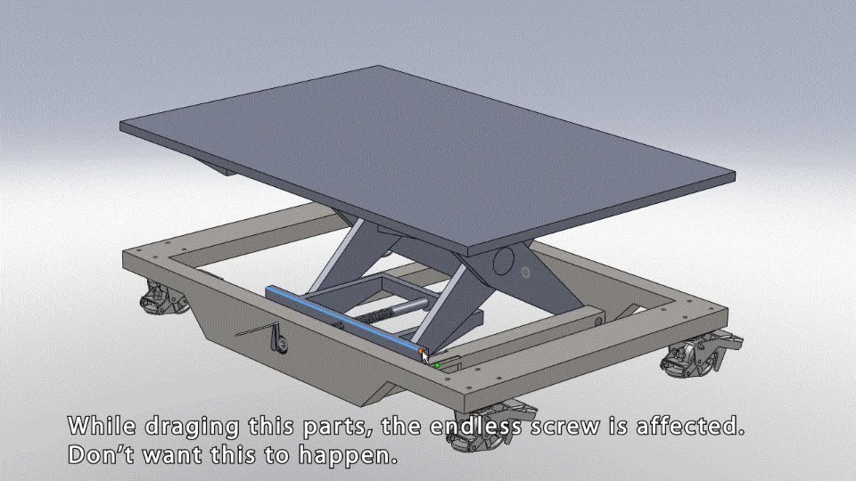

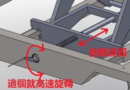

1 - How do I make one part doesn't have back-force to the first parts. Like in attachment 1 - Mechenic.png, How do I make endless screw can control the sliding component but the sliding component not be able to drag by mouse?

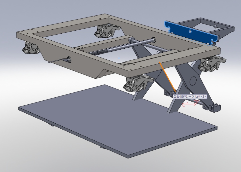

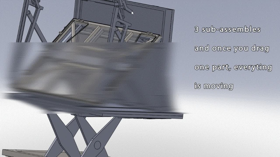

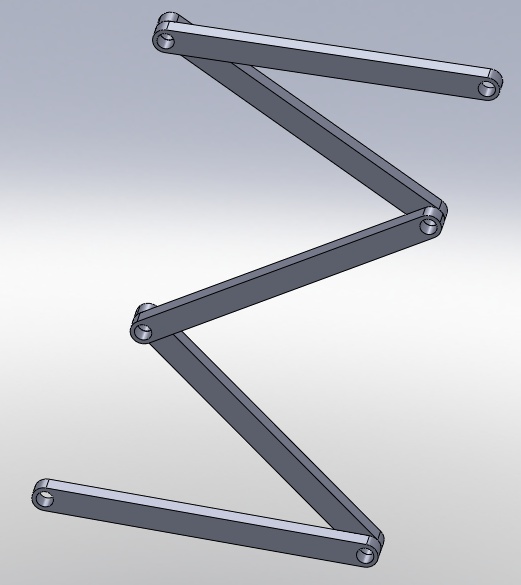

2 - A chain like this(Mechenic_02.png)how do I make the next segment do not affect the parent segment? (a large assembly with many flexible parts always encounter movement error if the movements are not decoupled)

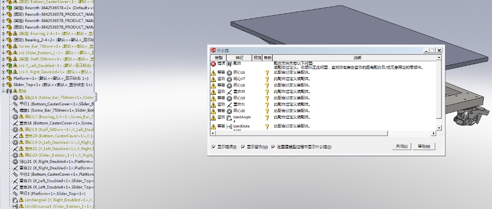

3 - When I trying limit distance and angle at the same time (like an X structure), I always get error "overdefine" and infact the parts can still be moved and not fully defined yet when I try to limit another parameter, it always says "overdefine".

For your question 1, you need to use Screw Mate
For your question 2, you can make several different sub assemblies and use them
For your question 3, please upload an example file having issues. Make sure you upload all the parts and assembly for this issue. You may use Pack and Go

So for 1- the situation is like: attachment capture-2.gif. when I drag the slider, or any part attached to it, the screw turns rapidly. What I want is to get rid of this counter force or this backward effect. To make the mechanical force oneway only. because this lead to 2.
2- capture-2_2.gif. 3 sub assembles put together, set flexible, but if you drag one part, everything start to move around randomly.
3- When only angle is limited, SW_Angle_0.png could happen sometime. When only distance is limited, SW_Dist_0.png would happen.
     When I limit both, everything just goes wrong like SW_AD_0.png.

Victor without looking at the actual files, it'll not be easy to recommend or suggest you anything.
