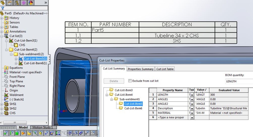

i just tried sw2014 and built a simple test model.
basicly, i drew a line and built 3 structure members, there were 2 SHS and 1 CHS.
Then I selected 2 SHS and built a sub-weldment. After that, I updated cut list
As you can see in attached picture,
Well, the question is when i built the BOM, it only shows the 1st level of cutlists.
I can see the inherited properties in sub-weldment, but how to show them in BOM?
Is there any setting to set the levels in SW?
