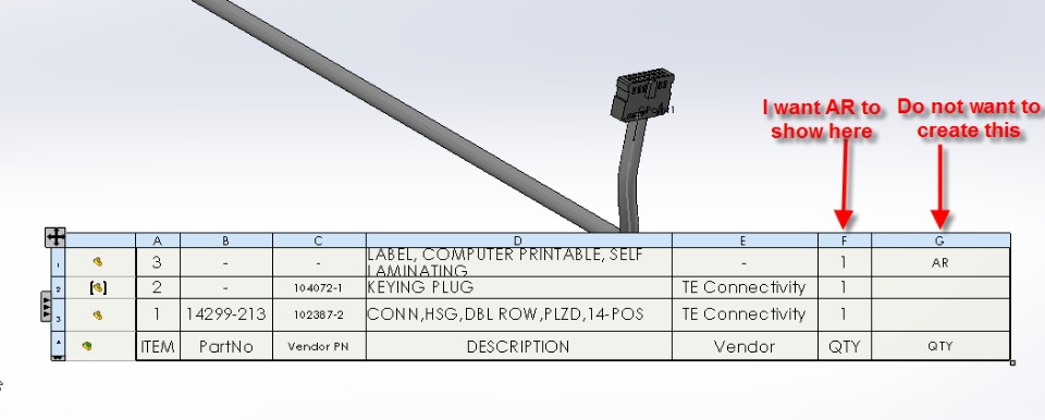

Quantity in BOM
I would like to have "As Required" in the QTY filed on the BOM for stuff like label, wires, glue etc. Someone told me to add a custom property to the item but when I add the custom property, I have to add another column to the BOM template to show this new custom property. I do not want to add another colum but to have the As Required shows up unter the regular QTY column.

There is solution without using API/Macro
You can add IF statement to BOM column.
First you need to identify this special items. - Add to them custom property - ie. "Extra item" with value set to 1.
Then add column. Click header and choose equation icon.
IF(`ExtraItem`=1;"As Required";'QTY.')
Then you can hide QTY columt and that's it.
