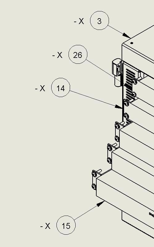

Qty value next to balloon showing up as "-"
When I create multiple configurations to show step by step exploded views, and then place those views on a drawing, if I link those views to the BOM on sheet 1, I get the correct item number in the balloons, but the qty values next to the balloon show up wrong.  However, if I uncheck the link to bom option, I get the correct qty values next to the balloon of the component that the baloon is pointing at, but the balllon has the wrong item number in it.  What is going on?

Just had the same issue. My BOM did not include the configuration I was referencing because I made the configuration after placing the BOM in the drawing. Simply click on your BOM, and in the Property Manager select Configurations and select the configuration you are referencing.
