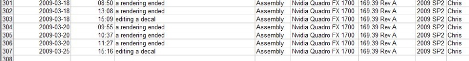

I have seen problems in two instances, one is when I amediting a decal. These files are located on C:, and I think Vista'sUAC gets angry that Solidworks is trying to mess with files on theC disk. In the end I started working with decals in the Documentsfolder and haven't had a crash for that reason since.
The other instance is when a rendering to file is complete.Thankfully, the rendered file is intact, but solidworks hascrashed.
I document every crash I have, which helps me go back and rememberexactly when and what caused the crash. See the image.
