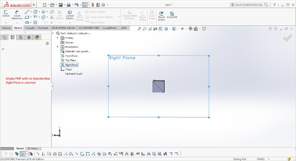

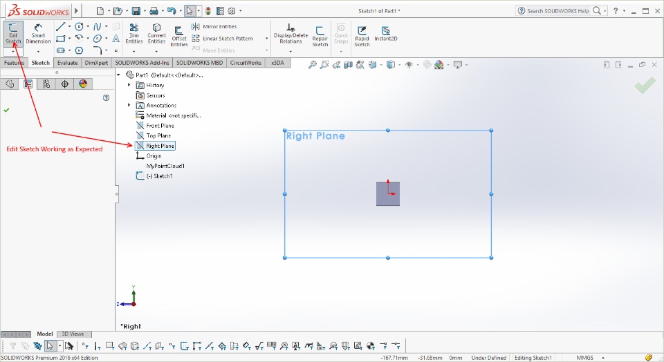

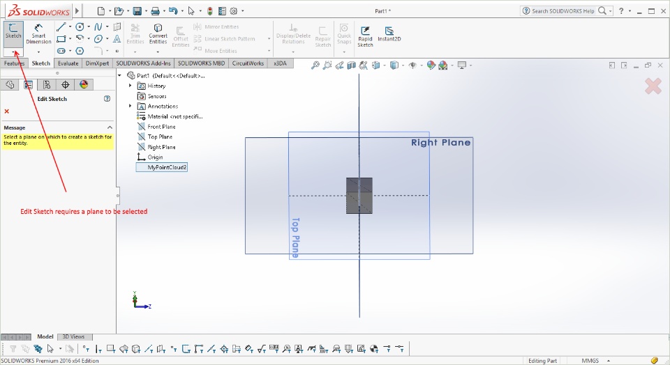

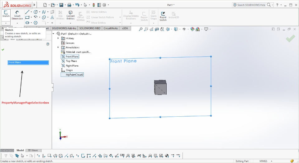

When i create a PMP with a PropertyManagerPageSelectionbox, the default selection functionality in Solidworks appears to not beworking.  I want to be able to allow the user to select a plane and then for the Macro create a sketch on to the selectedplane.  Without the PropertyManagerPageSelectionbox everything appears to work but with the selectionbox, even with the Plane selected, Edit Sketch prompts for a plane to be selected.
Without the SelectionBox, everything appears to work correctly as before.  I can work around this by just using my own .Net controls to mirror the functionality but that would be a poor workaround.  Am i missing something there?  I'm doing this in the UI not even with scripts as a sanity test.
Also I'm not sure how it is best to get the selected object from the PropertyManagerPageSelectionbox,  I couldn't find a nice sample anywhere.  The way below is what I came up with pm_Selection is the PropertyManagerPageSelectionbox entity and I'm just trying to get selected RefPlane objects.  Is this the correct way to go about it or is there a way to get the features directly from the  SelectionBox entity.
