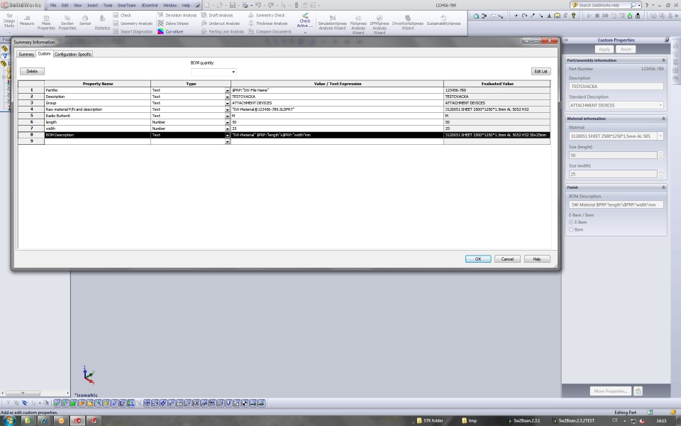

Hi,
as you can see on the picture I have correctly filled File-->Properties by a function. But I do not why I can not see automatically generated data also in the formula on the right side of the screen. There is just function shown.

Michal,
I am guessing that your string line is not typed out correctly.
Any change you can post your file here to take a look at?

Did you mean this?
I had the function like this $PRP:"SW-Material" $PRP:"length" x $PRP:"width" but this was not working correctly. Letters "$PRP:" were shown before correct record. So I have deleted these letters and I see it correctly in File-->Properties.
Maybe you know about more easier way...
