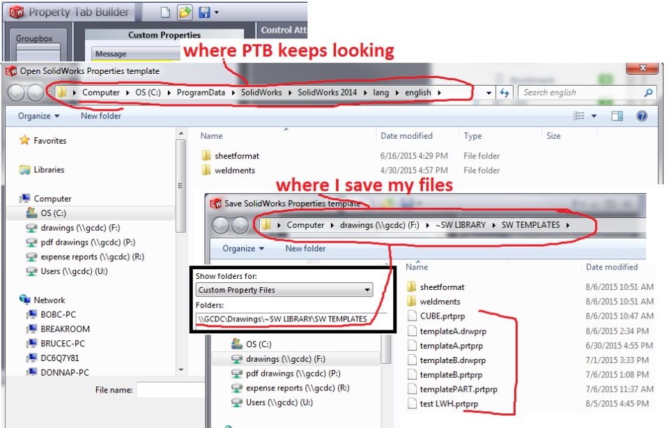

When I open a template I have previously saved in the Property Tab Builder it keeps looking in the SW default location and not in the location I specified in the File Location, which is where I save all my files. It is more of an annoyance than a problem... anyone have any suggestions?

The reason may be because of multiple part property files in that location
If you have only one file for each part, assembly and draw, it will show the properties in the PTB once the file is open
I had the same problem before and now I keep single file and works OK

I am running SW2013 SP3. I just launched PTB and clicked the file open button and it took me directly to my PTB templates which are located in a non-default network folder. I did already have SW running in the background when I launched PTB.
Initially, I do not see a setting in options/file locations. Also, a search of the registry did not pop anything up that looked promising.
I'll keep digging.

An additional bit of data: PTB seems to remember the "Last" saved location. Try opening one of your existing PTB templates and the re-save over the top of it with the Save As. This might reset PTB to the last used save location. This worked in my case.

I am running SW2015 SP 3.0. I tried Save As, but it continues to find the default location. I am running SW in the background as well.
PTB seems to know my "last save" location and goes to the correct folder, but does not seem to update my "last open" location to be the same.

Thanks for the suggestion. I tried removing the excess files, so there was only one file per type, but it did not change anything. PTB is still looking in the default location even though it saves to the correct file location.
Also I will have to have multiple CP templates of the same file type in one location. We have many models that differ widely and I am using the CP to drive the models, thus I need many templates to account for unique features and item types. So even if it had worked there would have been an issue.

Try deleting the ~ from the folder name.
