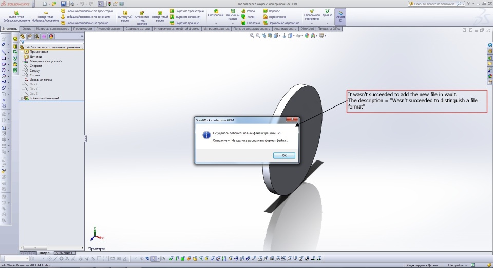

After detail creation in SolidWorks 2013 SP5 I fill properties through Property Tab Builder, then I try to keep in SWE PDM, gives out a mistake..
The model in vault doesn't remain.
If I don't use Property Tab Builder in model, everything remains well. But I should make then any changes to model through Property Tab Builder, there is such mistake in the card of data of SWE PDM...
How to eliminate an error?
