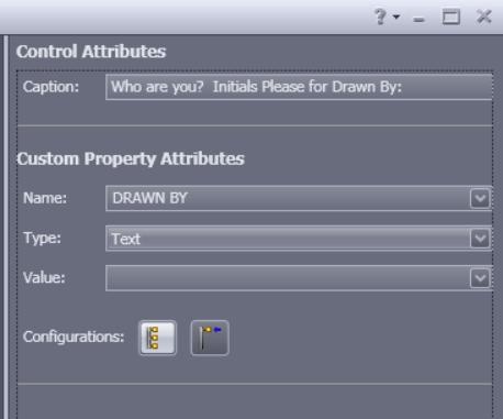

When creating your custom property tabs, every attribute will give you an option for configurations:
You can choose to have your attribute show up in the custom tab (file specific) or the configuration specific tab.  Seems simple enough.  However, in some PDM systems, there is some data that you will want to show up in BOTH the custom and configuration specific tabs in order to map all of your variables correctly.  Enterprise PDM, for instance, keeps track of custom tab and configuration tab data on seperate cards.  Nobody wants to write data in twice, is there a way to write the information into BOTH custom and configuration tabs within the property tab?

Properties which exist in one tab should not exist in the other. Data entered in the Config Specific tabs, override the date entered in the Custom tab.
It is for that reason we decided to use only the Config Specific tab for all properties.

The best way to do what you are looking for in the lease amount of time
may be to create a design table.  That way you can see all of the configs
at once and change the properties in one setting.
