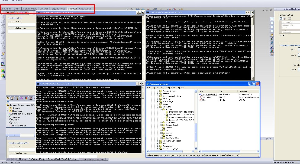

SF
SF 2011-02-28
Hi Chris,
Your addon allways run with this:
ngen сouldn't help
SF
SF 2011-02-28
You have .NET 4 installed?
Which batch file did you use to register the assemblies?
Can you post the output of the batch file?
Can you show the registry keys for your addins?
SF
SF 2011-02-28
Oops all work. After use the batch file's. All appears except flyoutpanel. On right-mouse-button it is not activated
