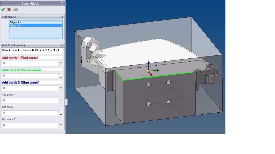

I'm in the process of adding a custom PMP for a macro feature that creates a stock block for our CNC department. Why we are not just starting with a stock block and cutting away from that is another story.
Anyway I am finding some difficulty with setting the colors of labels and setting labels to bold. You can see the red, green, and blue labels have a white background at the very right end of the label. I've tried setting the background via CharacterBackgroundColor but that only sets the background behind the labels caption. Do I need to add a bunch of spaces to the end of my captions to completely cover the entire background of the label?
Also I have found that I need to call the label methods once before showing the PMP and once after in order for the methods to take effect. Any ideas?
pmp_Label_AddStock1.CharacterColor(0, Len(pmp_Label_AddStock1.caption) - 1) = rgb(255, 0, 0)
pmp_Label_AddStock2.CharacterColor(0, Len(pmp_Label_AddStock2.caption) - 1) = rgb(0, 255, 0)
pmp_Label_AddStock3.CharacterColor(0, Len(pmp_Label_AddStock3.caption) - 1) = rgb(0, 0, 255)
pmp_Label_AddStock1.CharacterBackgroundColor(0, Len(pmp_Label_AddStock1.caption) - 1) = cmd_App.GetUserPreferenceIntegerValue      (swUserPreferenceIntegerValue_e.swPropertyManagerColorBackground)
pmp_Label_AddStock2.CharacterBackgroundColor(0, Len(pmp_Label_AddStock2.caption) - 1) =      cmd_App.GetUserPreferenceIntegerValue(swUserPreferenceIntegerValue_e.swPropertyManagerColorBackground)
pmp_Label_AddStock3.CharacterBackgroundColor(0, Len(pmp_Label_AddStock3.caption) - 1) =      cmd_App.GetUserPreferenceIntegerValue(swUserPreferenceIntegerValue_e.swPropertyManagerColorBackground)
pmp_Page.Show
pmp_Label_AddStock1.CharacterBackgroundColor(0, Len(pmp_Label_AddStock1.caption) - 1) =      cmd_App.GetUserPreferenceIntegerValue(swUserPreferenceIntegerValue_e.swPropertyManagerColorBackground)
