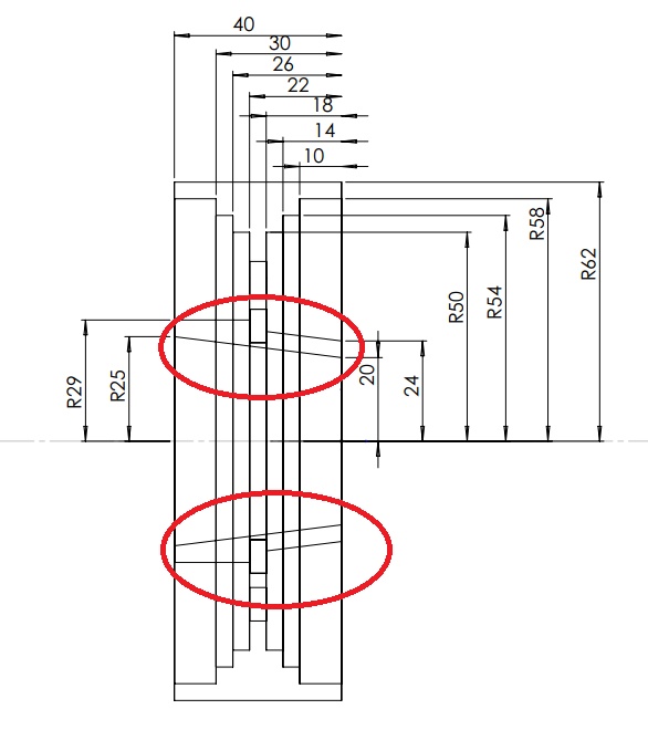

I've attached the SLDPRT file to the post. I'm very close to the right geometry. I'm just a little bit off in terms of mass and surface area. I believe the problem lies with the positioning of the holes in the hub. They aren't fully defined, and I can't figure out how to fully define them. I'm also unsure what the slanted lines in the below diagram of the part are supposed to represent (circled in red).

you did not include any details on what you want for the holes...
for the slanted lines, they appear to denote tapered/conical faces.

I believe your original question was how to define the bolt pattern.
It wasn't clear on whether you needed help with defining in model or on drawing, I choose the latter.
For a bolt circle, the centermark annotation has an option to create these types of call-outs.
In the example B.C. = Bolt Circle
For the circular features, I would use diameter dimensions instead of radius dims

Collin, how come 1mm, I see 5mm. Isn't it?
CZ
CZ 2021-03-26
Then again, looking back at the dimensions, it makes sense. It's a 1 millimeter vertical drop across something 40mm wide.

Ah, thank you. Odd that the taper really doesn't show up on the rendering of the part. Seems like the taper is only obvious when looking at the rendering in conjunction with the 2D view.

the dimensions show do (poorly) define the holes -  there is a size, a distance from the center (it should have an "R" in front of it to note that it is a radius), and an angular spacing (though there should be a (TYP) or 4X added for clarity).
and if the noted face in the lower view was not tapered, the noted line in the upper view would not be there.

Ah, you are correct. Here is the rest of the information I was given:
I don't see any tapered or conical faces in the rendering of the part, though.
