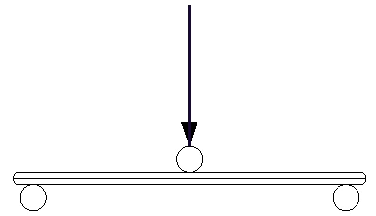

Hi folks,
I am trying to determine the relative flexibility of a small device about the area of credit card. It's about 2.5mm thick. I want to bend it in the middle and restrain it at each end over a pair of 6.4mm dia. cylinders. My study wants to see the effects (stiffness) of different internal geometry with an applied load at the middle. This load is distributed over a similar 6.4mm diameter cylinder. See the pic below:
I am having difficulty restraining this properly. I will be taking the Simulation training but need to determine this sooner.  Any guidance would be appreciated!

Well, first thing is that the stiffness will be very closely coupled with the materials and their thickness on the outside (top and bottom of the card - they will act like the flanges of an I beam). It is unlikely anything you do on the inside will have much impact on the structures stiffness assuming the outside bits aren't trivial. If you must proceed you can set it up as a contact problem (conceptually simple but not very efficient and could be a bit tough for a newbie to interpret) or you can quarter symmetry (if it is appropriate) or not and use the remote load restraint option to allow the ends to rotate and apply the load in the middle along a line. You will need to split the faces where you want to attach the remote/load restraint (maybe use a line), you will need a coordinate system (I would put it on the aforementioned line in the middle of the card) restraint the appropriate degrees of freedom, apply the load  and you should be good to go.open the remote load restraint under the loads menu and hit help for more info. Good luck. I have attached a file that illustrates its use.
SF
SF 2010-03-03
Not sure if you can see the feature tree. If you zoom in you should be able to see the way the study was formed.
I've defined no penetraton contacts between the parts. The bottom cylinders rest on a vrtual wall which is a fixture. I used 'soft spring' stabilization as this arrangement could easily 'roll off the page'.
Let me know if you need further assistance. Good to hear you are doing the course. I have done two of the FEA courses and believe it is time and money well spent.

And here it is again with the load applied. I applied the load by using a plane as a reference for direction.
The study ran in less than a minute.

Had a problem with the results when I checked the deformation plot. Always a good idea to check to see if the deformation is what you would expect. I was able to overcome the problem by suppressing the global bonded contact which affected the bonding of the top roller for some reason.

The "card" is an assembly of several components made from varying materials. I simplified the illustration for the sake of the basic question. The outside material is a plastic and is more like a 5 sided box. It's stiffness will have an impact on the thin components inside some of which are very brittle.

Thank you for the illustrations and the effort! You've modeled this very close to what I am looking for. I have internal features inside the "card" part that will undoubtably influence the overall stiffness. With your tutelage, this is the scenario I will play with to see how I can influence the structure. One thought would be to add stiffeners (steel) into the molded part to see what they will do. Of course cost is a big factor and adding extra parts may not be an option!
