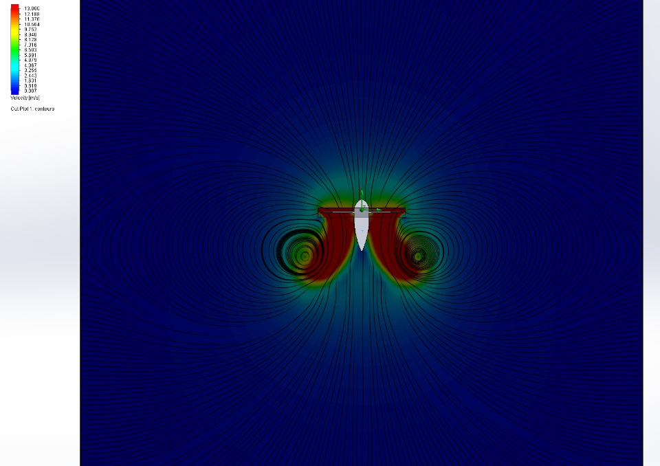

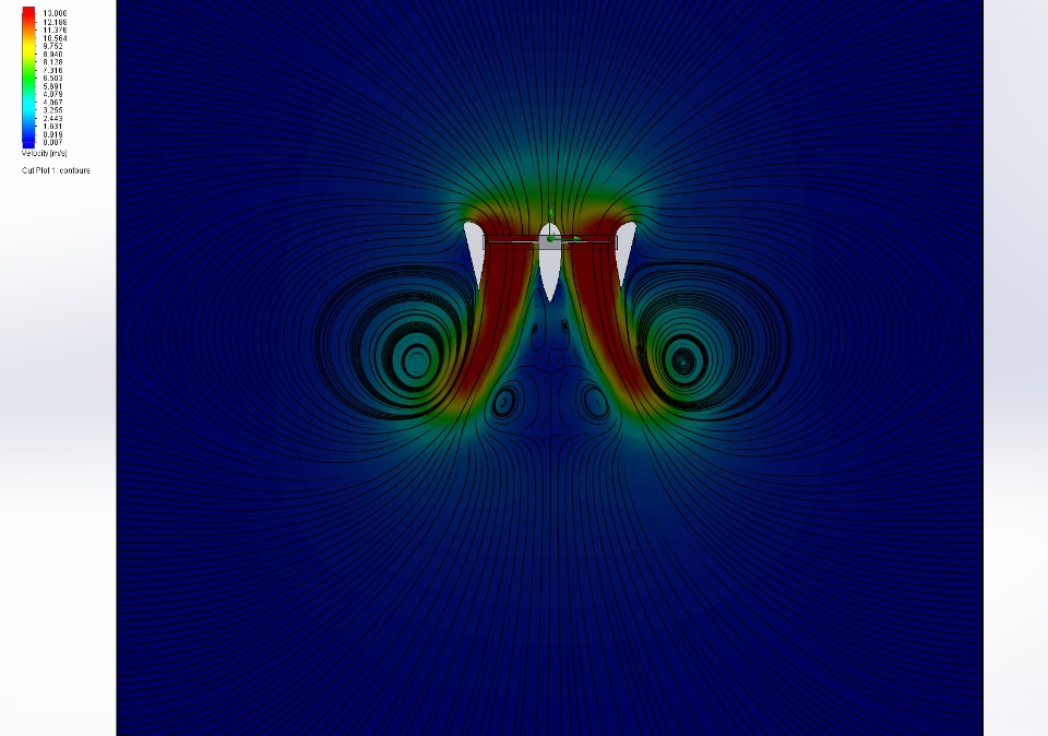

  1. The propeller wash diverges, it should converge.
  2. The propeller wash dissipates almost immediately.

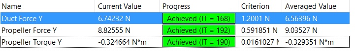

  3. Propeller thrust is higher in the free case than with a duct. From what I understand, theory states that edge effects would be detrimental to the thrust of the free propeller.

Ducted propeller setup:
Non-ducted propeller setup:
