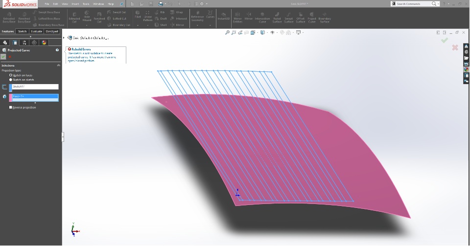

I'm trying to project a sketch onto a surface, but the sketch has multiple closed profiles, and for some reason SolidWorks seems unwilling to do this. Is there any workaround for this other than creating and projecting 20 separate sketches?
It has no problem projecting this:

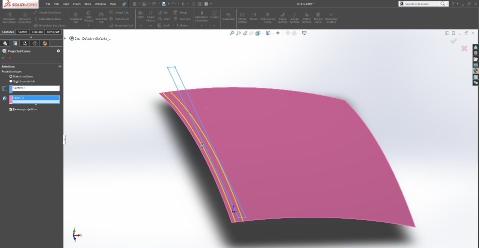

But projecting this is just way too difficult, apparently:

Hello,
Do you need the lines connecting the rectangles (by which I mean the rectangle of the upper image)?
If not, in the sketch, linear pattern the rectangle lines at the required spacing.
Perhaps this will get you to where you need to be.
Cheers,
Kevin
