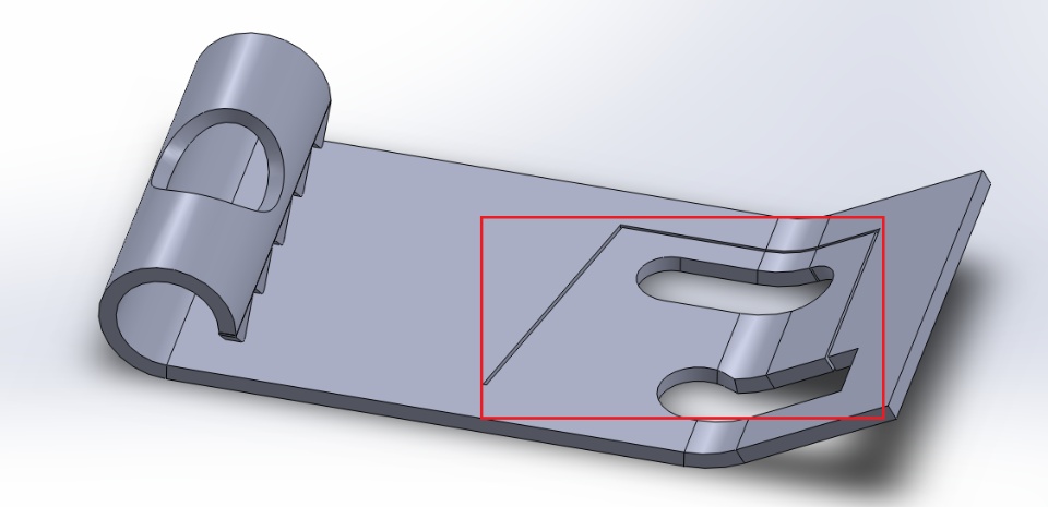

My current project is making a model of a mouse trap, and the release mechanism is made of sheet metal (in real life, and in the model)

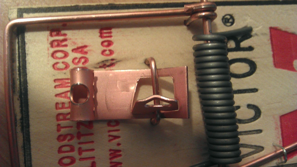

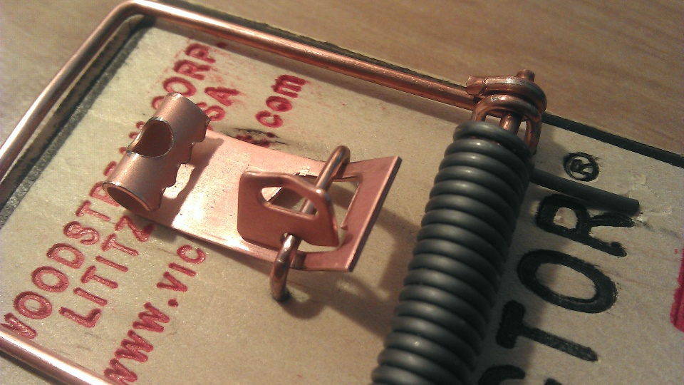

The release mechanism I am trying to model looks like this:

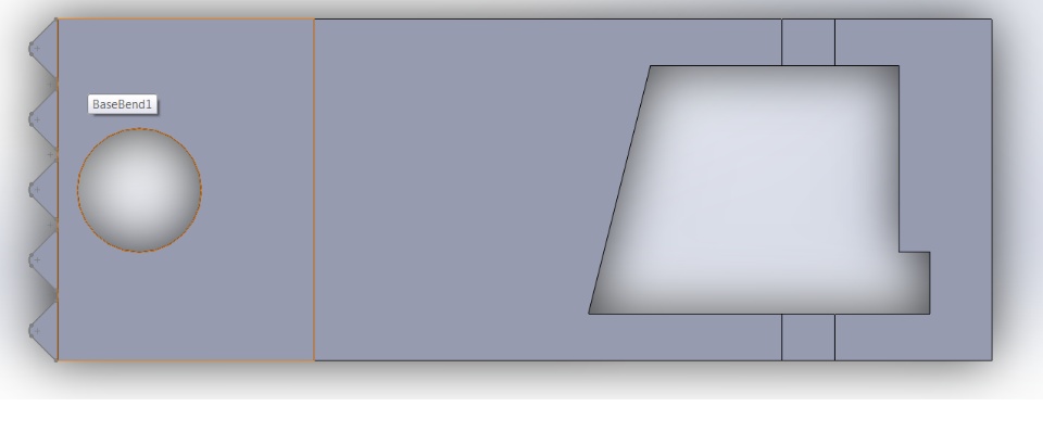

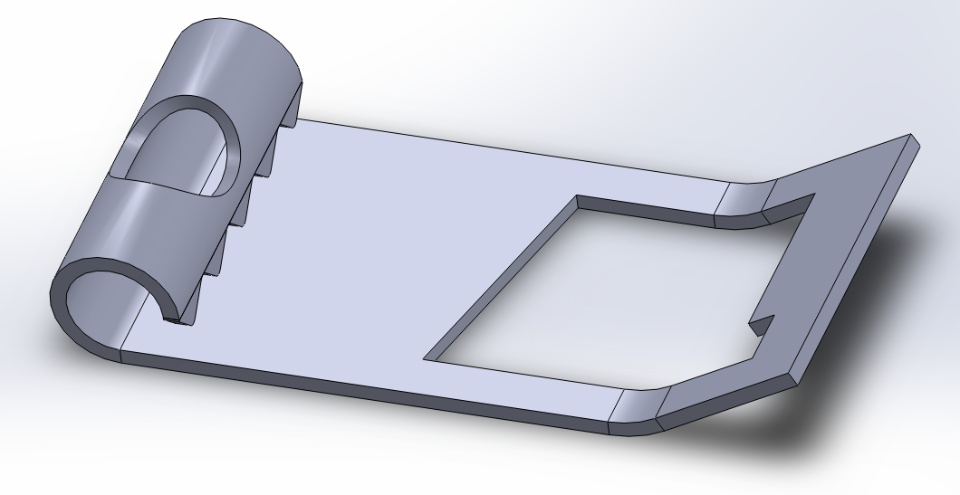

The sheet metal part I currently have made looks like this:

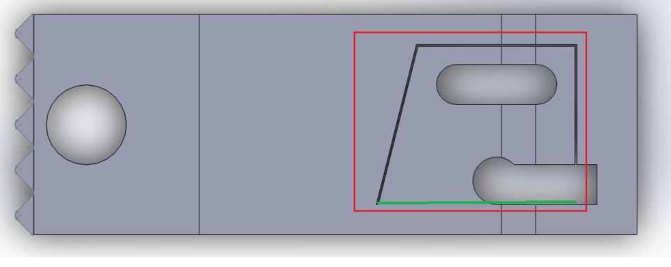

I can't seem to figure out how to create a flange from the part surrounded by the red rectangle, along the green line.  After experimenting for a while, I decided to try an alternate approach...

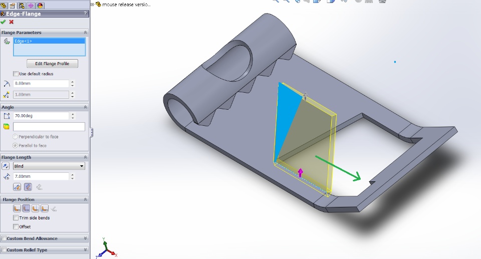

and creating a flange along the bottom edge.
Unfortunately It seems to me I am limited to the length of the edge as shown here:

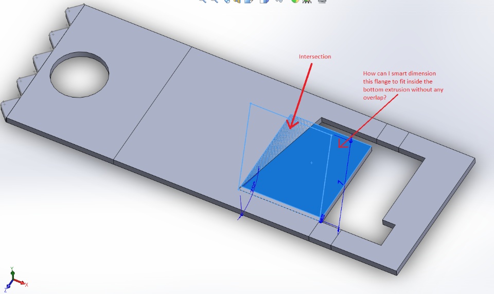

However, I havent been able to change the dimensions of the flange easily.  I would like to extend the flange in the direction of the green arrow, and change the dimensions of the flange to remove the blue triangular area. When I flatten the flange, the part looks ends up with overlapping material:
Is there any easy method to 'smart dimension' the flange to fit inside the extruded area when flattened?  Or are both my approaches incorrect?  Perhaps there is an alternate, method that is much better?
