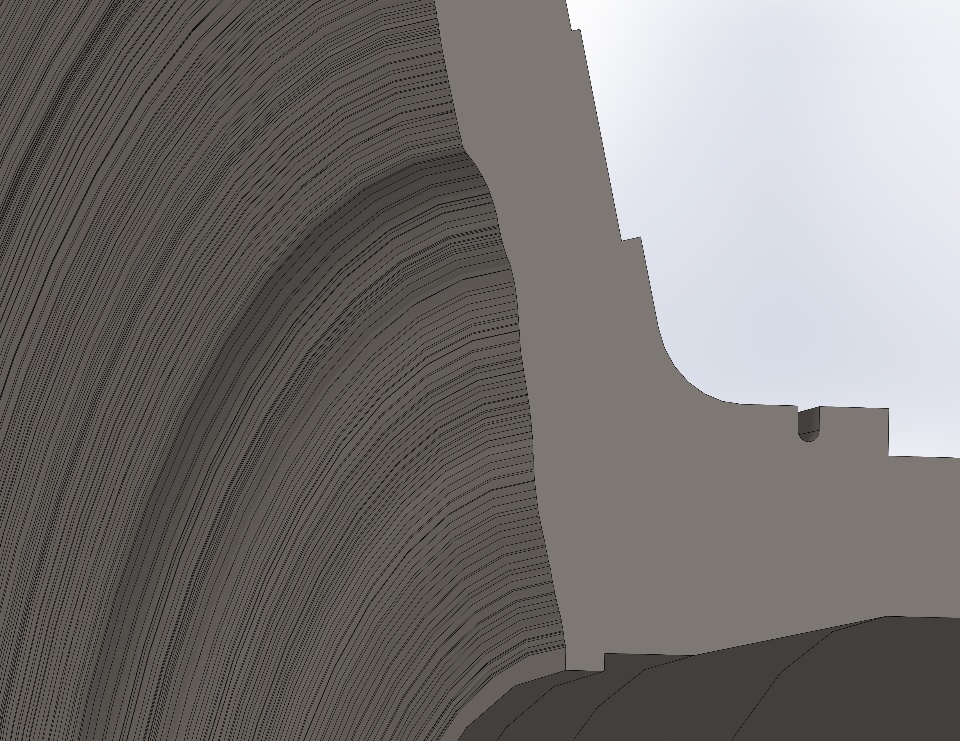

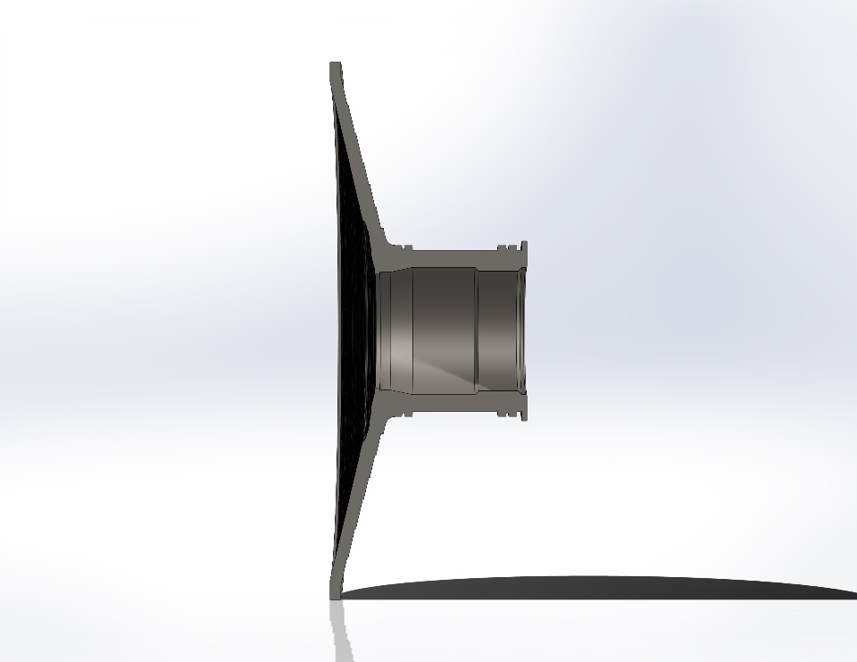

Hi everyone, I'm trying to do a static analysis to a ball mill discharge trunnion, which is compromised because of loose of material. I've done a revolved profile of it with the worst condition. The thing is that the accuracy of the profile makes me have problems to create the mesh to solve it. How can I do? ask me if you have any question about the problem. You can see a picture of the profile attached. Thank you!

Given the images you attached to the post the mode looks like it would require the addition of mesh controls in order to be able to mesh.  Since it looks like you have a single body you may want to employ the mesh method shown here (GoEngineer - Simulation: Troubleshooting why a single part will not mesh).  It will help to narrow down where additional mesh controls are required.

It looks like a revolved autoCAD sketch made from a highly segmented polyline. Why not redo the thing in SWX and it will mesh no problem.

I'd agree with Bill, whether that's an autoCAD sketch or imported geometry from a survey it looks a bit overly complicated and/or possibly having bad geometry. Remodelling and making some slight simplifications will likely help you.
