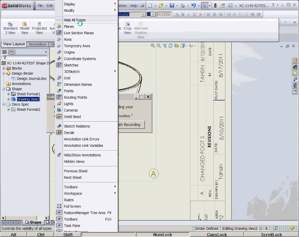

I just installed 2011 and SP4.  I was looking around and noticed a new command.  Insert, Modify, 3D Drawing View.  Not knowing what it was I tried to select it.
Every time I try to move my mouse over one of the fly-out menu choices the main menu choices (Insert, Tools, 3D Control, Window, and Help) underneath are selected.
Is this not the most basic of things for programs to do.  Does anyone test this software.  Within the first couple of hours using the new software I've found 2 problems.
See the attached video.

I believe that most people don't see this as they don't run a resolution low enough such that the longest menus don't fit vertically.  If I change my resolution to an ugly 1024 x 768, I can see the same behavior that you are seeing if I drop down the View menu.  It has enough choices that it won't all fit and is actually stuck up over the menu line. And when that menu line sees the cursor over it, the focus transfers to it rather than to the sub-menu.
I would consider this a bug and you should submit it.

Also, this bug is part of the core Windows UI, although SolidWorks does customize the interface, the issue is fundamentally a Windows error. And, as I'm sure you understand, I'm not seeing it on my system. As Wayne mentioned, you should still submit this as a bug; they might be able to fix it.
