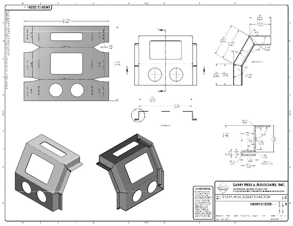

EVERYTHING I know about Sheet Metal comes from heavy reading in the SolidWorks User Forum and heavy web research. The best source I’ve found is http://www.ciri.org.nz/bendworks/ by Prof. Olaf Diegel in Auckland, NZ. I’ve completed “Reverse Engineering the K-Factor” on page 4 of his PDF http://www.ciri.org.nz/bendworks/bending.pdf (see ...FastiKFactor90180...PDF attachment) All measurements were meticulously recorded using a Digital Height Gauge and Granite Surface Block. Performing this K-Factor Study has shown us that our two Hi-Definition CNC Plasma tables can only provide Flat Blanks with an accuracy range of +/- 0.010. What ITI: International Technologies Inc. failed to communicate was that a Folder prefers a steady diet of 0.00X Flat Blanks. I entered all the study measurements into Excel and crunched the dataset. (see …BendWorksKFactor.xlsx attachment) Due to the +/- 0.010 accuracy range, I had to average the data to obtain a K-Factor for use in SolidWorks. We burned Blanks and started folding but got stuck at the 2nd Bend Step, the opposite hem. You are supposed to take your SW drawing, walk out to the Fasti, draw the bend profile graphically by touch screen, input all the drawing dimensions, and fold Blanks. The ITI Technical Guy beat into our heads that the Part Length given in the Graphical Controller is correct and we should calibrate SolidWorks to match it. Needless to say this has become the proverbial itch on the tail of the Bee.
The manuals shipped with the machine are NOT for our controller, (and don't exist yet) so it’s very difficult to learn anything from them. We must do a lot of experimentation just to try and understand how the controller operates. I have since learned, when angles from 175? – 180 degrees are needed, all the BendWorks formulas I have are rendered useless. The Outside Set Back cannot be calculated, because it becomes either too long, or parallel to infinity, thus unmeasurable. So far, my search for formulas to calculate 180 degree bends has yielded nothing. All I am able to find is hearsay, or “…my shop uses this…”, or some obscure references without any explanations. (See the …CustBendAllow.jpg attachment) These five choices in the drop list are available for hems in SolidWorks, but I don’t have the formulae to hand calculate them. Logically my gut tells me I need a different "value of one of those five choices" for my hems to give the correct Flat size. I just don't know where to go from here. We've bypassed our distributor and are going direct to the manfacturer for help, unfortunately they're in Germany. This is why I've decided to call upon my fellow SW'rs for help
Additional Attachments:
LW20131223B_StudyHem_0.3542K.PDF (this is the Hem Study part I’m working on currently)
W20140116_HemSty1&2ScreenCaps_DownRez.pdf (this is the Hem Study Fasti Controller screen caps)

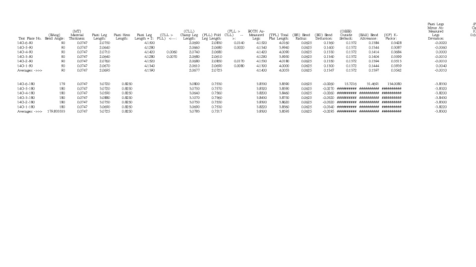

B: Bernie: If you're looking for + or - .005 accuracy I would suggest you use bend deductions.

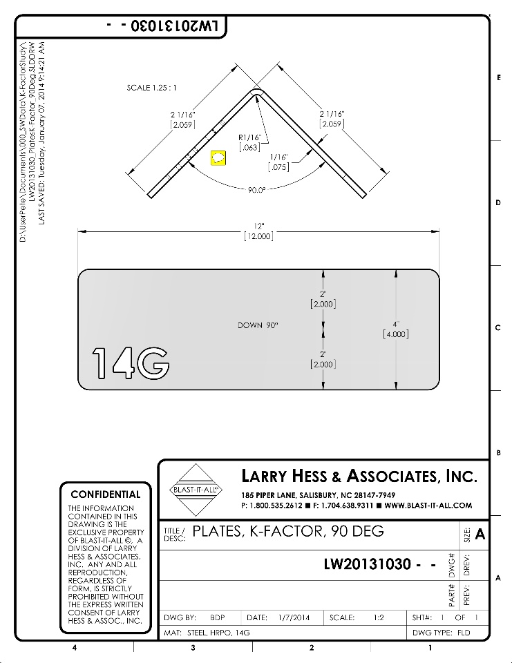

P: Pete: We're getting ~ + 0.000 - 1/16 on our pre-fold/ pre-brake flat blanks. We're seeing ~1/16 to 1/8+ error post Brake Press, 1/16 on a very good day.
B: I inspect the flat pattern inside SW.
P: Is there some form of inspection process I'm not aware off in SW?
B: For me closed (tight flattened) hems use a bend deduction of 1/2 material thickness.
P: (see ...PlatesK-Factor_HEM.PDF attachment) This is the only hem we are planning to do. (at this time) It will always be done in 14G HRPO Steel. This allows us to paint the inside, so that rust trails will not form as our machines age in the field. Would you still bend deduct 1/2 material thickness for an open parallel hem?
B: If I remember correctly the folders use the 'other' angle so you might have an issue there. SW calculates bends using the angle the bend travels through. Folders (most often) use the European angle (no insult intended!). If you enter those numbers your bend allowances in SW will be off. Folders use 135 degrees for a 45 degree bend. Check this out to be sure.

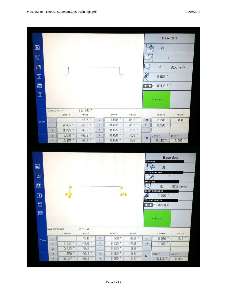

P: (see ...HemSty1&2ScreenCaps...PG1.pdf) First screen cap, 1 - 7 are the 7 legs of the part, column 2 is the leg length and column 3 is the leg angle. You quickly draw the part on the touch screen and then refine the the lengths and angles. Negative angles rotates the segment CW and positive angles rotates it CCW.

P: Right now I've folded 18G, 16G, & 14G. I've only done a 14G K-Factor Study since it's 80% of our production. I am getting an internal radius of 1/16 across the board. Be interesting to see if that holds across the spectrum. We only have sharp bend tooling.
(see ...SW-CustBendAllow.jpg) So, I just drop the list, select Bend Deduction, and provide a positive value? Gauge / 2, if you still concure after seeing the style of my hem? That's all there is to it?

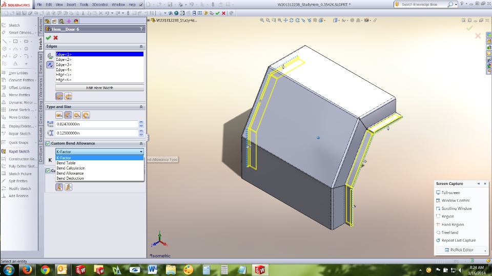

SW allows me to use Custom Bend Allowance > Bend Deduction, but puts a warning on the hem feature!
(see ...BendDeductionFAIL.png)
Says K-Factor is used if the angle is >= 180!
How can SW use a K-Factor when you can't even manually calculate a 180 bend to get it.
Makes no sense.
PP
PP 2014-01-17
Since SW wouldn't let me use Custom Bend Allowance > Bend Deduction, I switched over to K-Factor.
Flipping back and forth between the Flat Blank drawing and model, I manipulated the K-Factor while watching the Blank dimensions change.
I was able to walk the dimension until it syncronized with my Fasti Controller Dimension!
The final K-Factor ended up being 0.175.
Now that my SW Flat Blank dimensions = my Fasti Controller dimensions, I'll burn some new Flats to fold on Monday.

With Bernie’s help, I have finally been able to calibrate my SolidWorks Hem Study drawing to the Fasti controller. Not coming from a sheet metal background has made this a very arduous task to complete. I learned that the data we crunched from our K-Factor study was only part of the solution we needed. We could never get our SW drawing flat dims to equal our Fasti controller dims. Long story short, Bernie’s information showed me that we needed two different K-Factors. One for the overall part (0.3542) and another strictly for the hems (0.1750). I made the change, cut some blanks, and folded them this morning. These are the first successful parts we have been able to product without cheating. I just hope that these K-Factors continue to give me the correct flat dims as we move to a real world machine. I won’t be ready for a real world test for a short while yet. I will pass on how it goes once we run it.

Success!
The production drawing dims, for the hem side of the flat, equals the Fasti Controller dims!
The other side of the flat has a 0.026 variance.
But that can easily be attributed to our Hi-Def Plasma burn tolerance.
