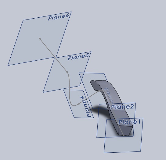

I want to sweep a profile along a twisted path (in 3D). In my sweep profile, I have a sketch segment that is perpendicular to Axis1, and this segment should stay perpendicular to this axis in the whole sweep feature. There for I choose alignment type 'Direction vector' and 'Axis 1' in the sweep feature definition.
The result of this sweep is OK for that, but the section of my sweep body isn't normal to the path after the first bend..
Does anyone know a solution to keep the profile section normal to the sweep path? I don't mind the section where the profile bends.
I don't use a guide curve because I need to be able to change my sweep path without have to update to guide path too.
Thanks for your help.

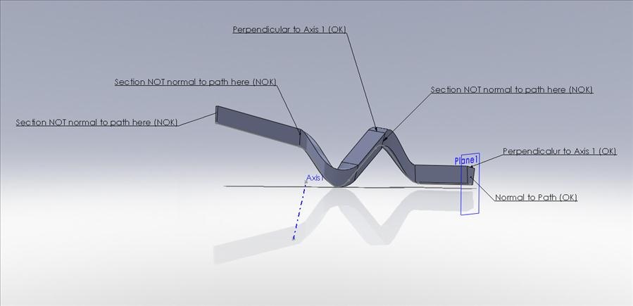

Keep normal constant doesn't work here:
The profile should be normal to the sweep path.
I have tried minimum twist too, this works for the normal of the profile,but then the top segment isn't perpendicular to Axis 1 anymore..

It will not sweep normal to the path because your path radii are too small.  When the section bends around the path, the model intersects itself on the inside of the bends.  This can be solved by making the path bend radii larger.

Still the same problem, with larger bends:

Same problem. The profile must follow the path so that the profile is normal to the path. See image attached.
I can realise this by selecting 'follow path' + 'minimum twist', but then the perpendicular relation between the segment on top of the profile and Axis1 is lost..

I think that perpendicular to the path for a 3D curve will involve some twist which is why the profile does not remain aligned with the axis.

Simon,
Follow Path + Minimum Twist is the correct method. As you see, this will not keep that top face normal to the axis. There is no way to meet both of your requirements, as they are contradictory. Is it only the top face you need to be normal? If it is just the top face then you can do this in two steps. With a path that moves through all 3 dimensions, your design requirements are physically impossible.
SF
SF 2010-10-03
It's not the top face that needs to be normal, but the edge on the top face of the profile must be perpendicular to Axis 1 (annotations with arrow in screenshots indicate the edge - not the face).
The sketch plane of the profile must be normal to the path in every section of the sweep body (except bends, but is should also be possible in bends..).
Having this first condition, the profile orientation isn't fully defined yet, because the rotation of the profile sketch around the path axis is still free. This rotation is limited by the second condition: the edge on top of the profile sketch must be perpendicular to axis 1.
As you see, I need a combination of 'follow path' AND the use of a direction vector.
