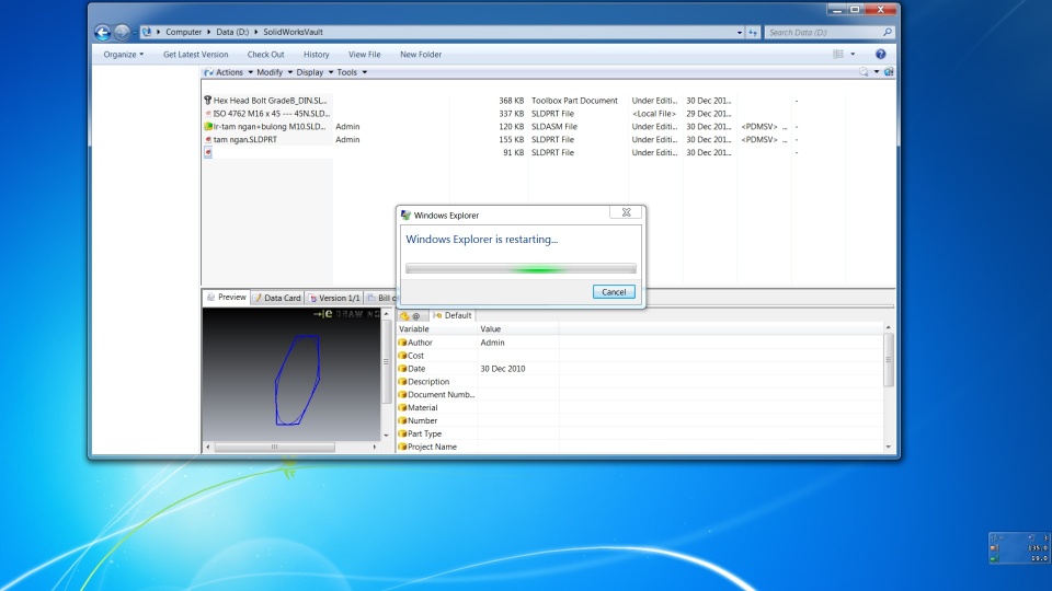

When i right-click to any files of solidworks vault, windows explorer encounter a problem. I've never encountered that problem before. It's just appeared for 1 hour ago.
Please help me solve it. Thanks very much.

I'm using Solidworks Enterprise PDM 2011 Sp0
I have 3 pcs:
The first one: windows 7 ultimate 64 bits, installed vault server and client (editor)
The second: windows xp professional 32 bits, installed vault client (editor)
The third: windows 7 ultimate 32 bits, installed vault client (editor)
The third pc work well.
The first and the second, when i right click on any file in vault view, windows explorer encountered the problem. I've tried to change view state to details, thumbnails ..... but still crash.
