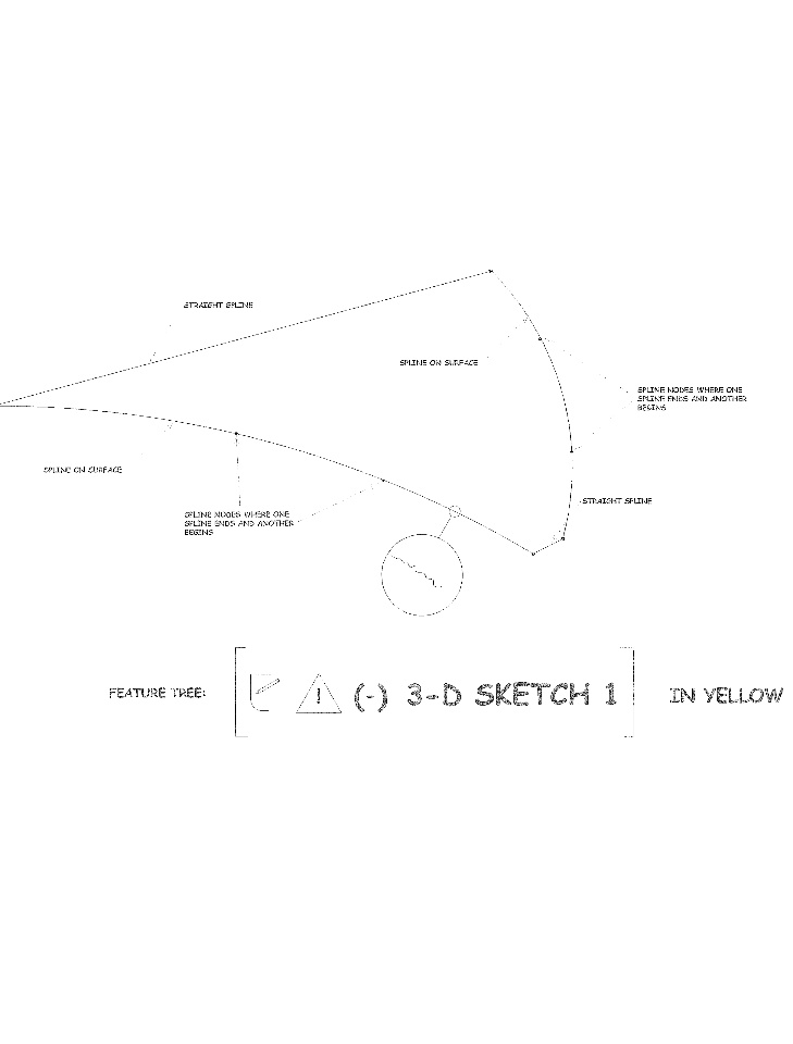

Dear Experts:
    After much adou and angst I have managed to draw the attached 3-D sketch in an assembly file and copy it to a new part file. All the lines of the sketch are now black, However, the sketch has the following warning attached. "The sketch has not been updated because solving it would result  in invalid geometry (such as zero-lentgth line.) Consider: *Deleting the  invalid geometry *Changing relations or dimensions to eliminate the  invalid geometry."  I would like to fill in the area between the lines with something like a "Boundary  Surface" but I can't, probably because of the warning. I have dimensioned the drawing, but it doesn't seem to help. There doesn't seem to be any invalid geometry.
On the surfaces tab tool bar, most everything is greyed out except "Extrude Surface" Revolved Surface" Lofted Surface" and Boundary Surface. However, none of these will except inputs from the sketch. I guess the question is what is wrong with this drawing?  There are no gaps and all the corners are merged. What am I doing wrong?
                                                                                                                                                                Donn

AW 2013-09-08 Best Answer
Post your part file.  It is pretty much impossible to troubleshoot a pdf.
Cheers,
Anna
AW
AW 2013-09-09
Donn,
You have two sets of line geometry overlaid on top of one another in your sketch.  Delete the double data.
With a Loft each contour needs to be in its own sketch.  http://www.youtube.com/results?search_query=SolidWorks+Loft
Also try using a Fill Surface if you wish to keep all your contours in a single sketch.  Insert > Surface > Fill
