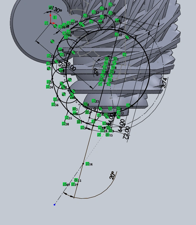

Whenever I try to fully turn the main - cross spherical gear around the monopole gear at 130 degrees around the monopole gear, while the CS gear is rotated at 65 degrees something weird is happening. From research it seams that Soidworks solver is playing some tricks on me and the result doesn't make any sense, it seems like Soidworks decided to throw the constrains out the window.

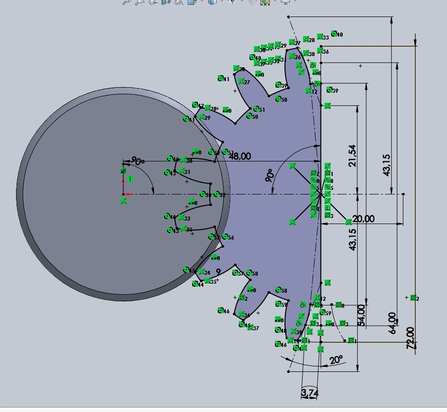

Below is a screenshot of the right gear, it's dimensioned weirdly in an attempt to remove ambiguity.
The second screenshot shows what happens at 130 deg and 65deg rotations
