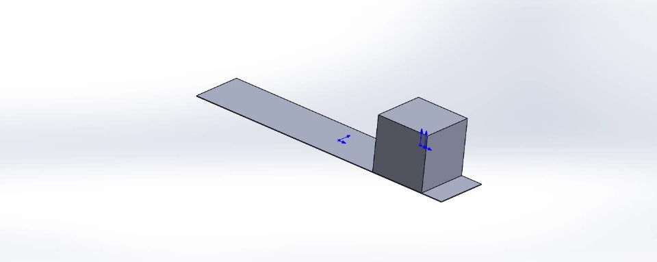

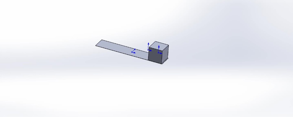

Then I proceed to simulate in SolidWorks Motion this problem, but what I find is that it fails when the
dynamic friction is quite high (like this case) and I get the wrong answer. I also demonstrated that
using a force equivalent to the friction force instead of using dynamic friction works fine. But I really need to
know why it fails using dynamic friction. Here I attached the files:
The assembly "Force" is the system using the equivalent force instead of dynamic friction, which works fine.
The results from the assembly "Force" are in the excel file "DataForce" which are the correct ones.
The assembly "DynamicFriction" is the system using the dynamic friction, which fails to bring the correct answers, and the one I need help.
