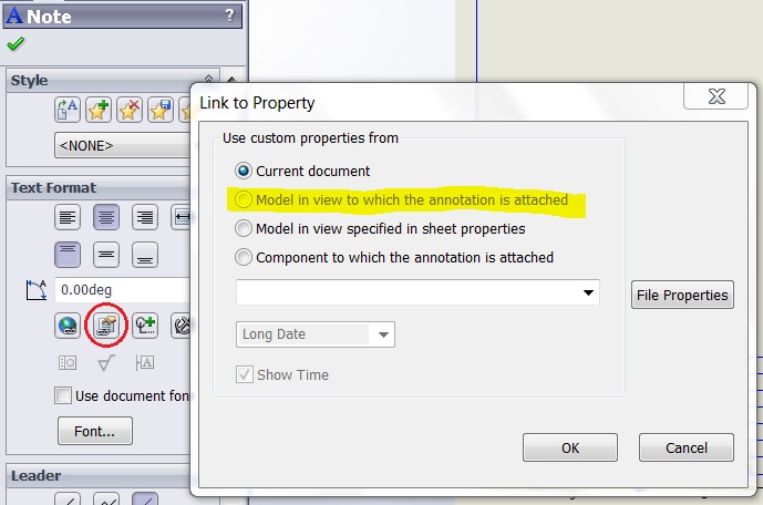

Hi to all,
i am new in writing the VBA code.
i have one drawing which have title block , notes and some view.
Block fileds are linked with the custom properties with i created in drawing.
Few notes are connected to the part by leader and these notes are also linked with the custom properties.
Now
Just i wrote a VBA code to open a drawing and to delete/add those custom properties and then rebuild the drawing.
in this process all fileds in tile block and note ( which is not having leader) are updating but those note which connected to the view by leader are not updating.
please help me

'Assignment of properties in drawing
Part.DeleteCustomInfo ("WBS")
retval = Part.AddCustomInfo3("", "WBS", swCustomInfoText, Val(WBS))
Part.DeleteCustomInfo ("Contract")
retval = Part.AddCustomInfo3("", "Contract", swCustomInfoText, ContractNumber)
Part.DeleteCustomInfo ("Project")
retval = Part.AddCustomInfo3("", "Project", swCustomInfoText, ProjectName)
Part.DeleteCustomInfo ("Revision")
retval = Part.AddCustomInfo3("", "Revision", swCustomInfoText, Val(Revision))
Part.DeleteCustomInfo ("DrawnDate")
retval = Part.AddCustomInfo3("", "DrawnDate", swCustomInfoText, DrawnDate)
Part.DeleteCustomInfo ("DrawnBy")
retval = Part.AddCustomInfo3("", "DrawnBy", swCustomInfoText, DrawnBy)
Part.DeleteCustomInfo ("CheckedBy")
retval = Part.AddCustomInfo3("", "CheckedBy", swCustomInfoText, checkedby)
Part.DeleteCustomInfo ("Material")
retval = Part.AddCustomInfo3("", "Material", swCustomInfoText, Material)
Part.DeleteCustomInfo ("Quantity")
retval = Part.AddCustomInfo3("", "Quantity", swCustomInfoText, Val(Quantity))
Part.DeleteCustomInfo ("Title")
retval = Part.AddCustomInfo3("", "Title", swCustomInfoText, Title)
Part.DeleteCustomInfo ("Sketch No")
retval = Part.AddCustomInfo3("", "Sketch No", swCustomInfoText, SketchNo)
Part.DeleteCustomInfo ("Elevation")
retval = Part.AddCustomInfo3("", "Elevation", swCustomInfoText, Elv)
Part.DeleteCustomInfo ("Sketch No2")
retval = Part.AddCustomInfo3("", "Sketch No2", swCustomInfoText, SketchNo2)
Part.DeleteCustomInfo ("Weld")
boolstatus = Part.EditRebuild3()
