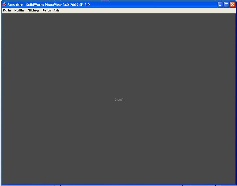

Since the last week, i have an error with the add-in PW360 2009 SP5.0, when i launch the app. she come's nicely but without interface... See the picture below
I already have re installed the soft 3 times, and i always have the same bug... If anyone could help me it would be nice.

Nothing wrong with your english!
Go to view at the top and chose reset layout.
hopefully sort your problem.

Re, thanks for your fast reply, i just found the answer. Apparently it's a known bugs and Mark Biasotti solve it.
I relink his message for people who've got the same bug.
<p>I have notice some users (Rob R.) as another internal user here having problems with activating the environments in the environments pallete. Currently you activate an environment by double-clicking on the icon in the environmental pallete. This is not working for some users on some systems. On my build/install all of these work for me but for one of our other SW users, the "Backdrop w/ Overhead Spotlight" is not working when you double-click on it. The rest of his environments do work when you double-click.<br /><br />Also, please give us your opinion on how how adding enviroments should work.<br /><br />In addition (and this is only something that I would recommend for you alpha users) is that if you are suspecting real problems with your build that others are not experiencing, you can delete your PV configuration file in your C:/Documents and Settings/<user>/Application Data/Luxology/SWPV_<latest build>.CFG  and relaunch PV.</p>
So, i just erase everything in the C:\Documents and Settings\\Application Data\Luxology and now everything is good.
