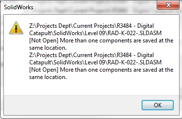

When attempting to save an assembly, (which includes virtual parts), I get this message which prevents the save from happening.

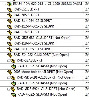

When checking down the list of the parts being saved the breakdown is shown as such

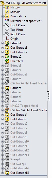

The problem seems to be the RAD-K-022 which is strangely shown to be within a part which is not possible in my experience....
Part itself shows no reference to the part.  Can anyone help as I am now out of ideas.

The problem lies in an assembly within the assembly.  This file shouldn't be copied at the time so I can't see why there is an issue when saving the room assembly
