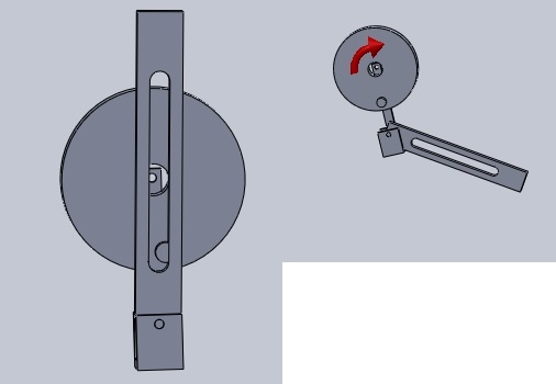

problem during assembly
i made this assembly it perfectly works so i saved it
but after that when i reopen it and recalculate basic motion then my plate direction got change(opposite)
SolidworksAssemblies

Works fine for me, check attached video.
Few suggestions: Don't post your files in RAR format.

What SolidWorks version and SP you're using.
Output the animation as avi file and check the results as this can be a just graphics glitch.
Try calculating at normal or slow speed and check.
If problem still persists, then please report to your VAR.

Did you tried the above options. Also update the video card drivers and check.
If nothing worked then report to your VAR along with the files.

hi ankush
select 3d precise contact.  Under motion study properties>use precise contact.

Motion study properties ---> check the box use precise contact.
If this doesnt work
decrease you motor speed
or
increase frame per second
all these options are available in motion study properties

NO SUCH OPTION FOR PRECISE CONTACT IN MOTION STUDY PROPERTIES
NAD I TRIED AT HIGH FRAME RATE AND RESOLUTION
AGAIN THE SAME PROBLEM

DEEPAK SIR PLS CHECK THIS AGAIN THE SAME PROBLEM
PLS CHECK MOTION IN MOTION LEVER GOES IN OPPOSITE DIRECTION

Reduce the speed of your rotary motor to something like 20 and calculate agian.
AG
AG 2013-10-17
SIR THIS IS THE PROBLEM
SW DURING CALCULATION AUTOMATICALLY SKIP SOME KEY
I TRIED AT LOW OR HIGH FRAM BUT PROBLEM NOT RESOLVED PLS HELP ME

actually it works in motion analysis but when i checked the same in basic motion problem is same...
deepak sir pls also help me if some time is skipped in b/w motion how to repair that
DG
DG 2013-10-18
Did you changed the setting for Motion studies??
I'm not sure why there would be gap in there. So please send these files to your SolidWorks Reseller for a proper investigation.

IS THERE ANY WAY TO RESET THESE SETTIONG FOT BASIC MOTION
DG
DG 2013-10-18
You can't reset them but you can set them as default for new motion studies.
