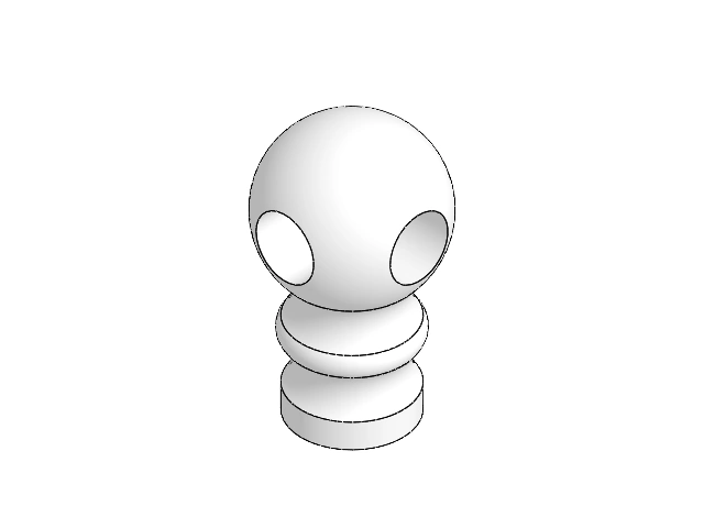

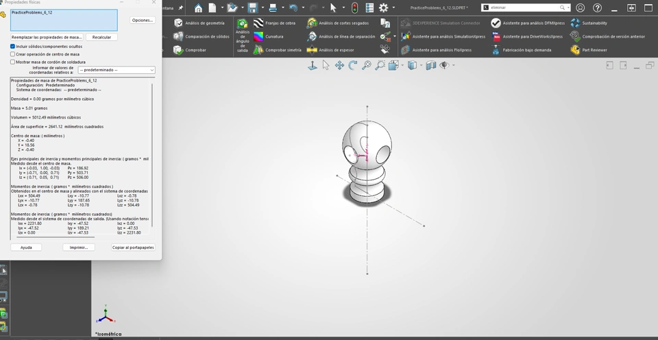

Hello again, in this case the result doesn't match at all, as you can see in the screenshot. I'm attaching the file of the part in case someone can confirm the result for me.

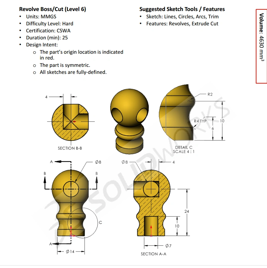

Initial sketch wasn't proper. Unless specified, arcs are tangent be it any. center point of R4 aligns vertically.
JK
JK2026-02-24
once you create first radius of 4 (from bottom vertical line), create rest of arcs with tangency as first preference

Since your 3 cross holes are the same, I will suggest a circular pattern (4 instances with one instance skipped) instead of repeating the previous cut (without any linkage to it).
