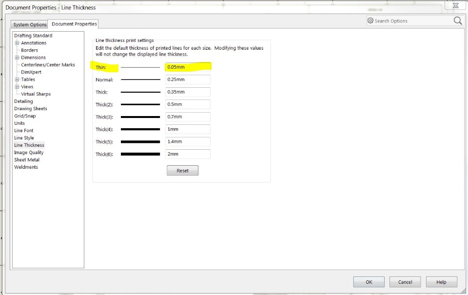

Printer Thin Line Weight Not Working
Anyone can help with this?/ I can't pass this value to SW through a macro.
    swApp.SetUserPreferenceDoubleValue swPageSetupPrinterThinLineWeight, 0.0005
SolidworksApi/macros
Answers 1
MF
MF 2021-04-09
Hi Frederick,
From macro, the value is in meters,
this is the solution: to print thin in 0.05mm
swModelDocExtension.SetUserPreferenceDouble swUserPreferenceDoubleValue_e.swPageSetupPrinterThinLineWeight, _
                                            swUserPreferenceOption_e.swDetailingNoOptionSpecified, _
                                            0.00005
