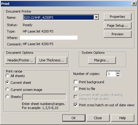

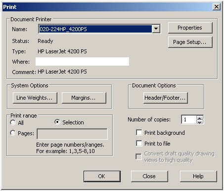

Is there a way to print just a windowed selection at thescale you want in either a PRT, ASM or DRW file inside ofSolidWorks without having to open it in eDrawings to do the print?We are trying to print out while inside SolidWorks a windowedselection of just an area no matter what file it is at a scale weselect (like in AutoCAD).SolidworksGeneral

File, Print, Selection, OK, Custom scale.

I think you better take a closer look. There is no Selectionin the Print dialog in SolidWorks 2008 or 2009 to choosefrom.

Taking a closer look, I see it as an option.
At least in a Drawing it is.
In an Assembly or a Part, this option is greyed out.

My apologizes to Janusz & Alan you are parially right. Itlooks as if in SW2009 they have changed the print interface. I'vetried looking at both a Off Domain and On Domain systems both inSW2008 and SW2009, a total of 4 workstations and found reqardlessof type of connection to printer and or and Workstation (LAN orLocal) that the results came out the same. See screen capturesbelow. First is from SW2008 and Second is from SW2009.

Yes, the print interface was changed from 2008>2009. No,there is no longer a "print selection" option, so you cannot printa small area to scale anymore.

I can get an accurate scale using Print Scale in Page Setupbut, can' t see any way to "focus" on anything. It looks to scalefrom center of page of any .slddrw?
This will force me to have to move any specific view to "center ofpage" before printing to get a view that I used to just place theselection box around! Arrrhhh!
