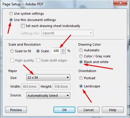

I posted a similar thread but have have decided to change directions - sort of.
I'm in need of a macro to Print to PDF (Not to be confused with Save as PDF). It must be, no matter what, a "Print as PDF" macro because my manager absolutely refuses to permit  us to use the "Save as PDF" option because of some printing issues recently.
The code below is what I have to work with, but I'm having some issues getting some standards nailed down.
1) At the very least, I need the print specification in the script to set the options as shown in the attached image below. How can I do this?
Right now, the script works, but my scales are off and adjusting the values below don't seem to have any effect.
    printSpec.FromScale = 1
    printSpec.ToScale = 1
2) This is more of a wishlist item, but if its possible, it would be amazing if this script could run silently, naming the PDF as the SolidWorks file name (minus the "layout" or "sheet name" as the PDF automatically adds this) and then save it in a predetermined folder on the Users desktop called "Export". Can this be done?
