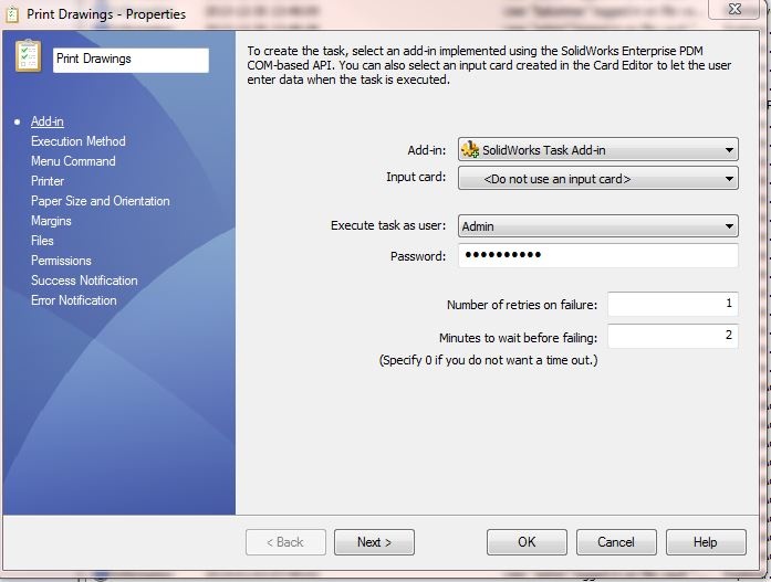

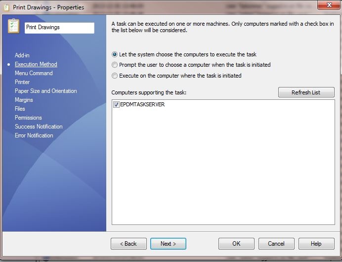

I can't get the print task to run. We have setup a taskserver on a virtual machine located on the backup server called EPDTASKSERVER. I have setup a onvert task for step, dwg, dxf and pdf which work great. which all execute as the Admin on the taskserver.
There are two transitions in the Engineering Design Control workflow that I want to use to generate prints of all drawings that pass through the transition. I have installed the network printer on the taskhost and configured it for the papersize I want, 11x17. I have the task set to run as Admin like the others as well as for notices to be sent upon failure or completion of the task. When the drawing passes through the transition the print task comes up but does not execute. I have checked the log file on the taskserver and there is no record of the print task. Nor are any notifications being sent.

When I run it locally I do get a log entry that says my printer is invalid. I aslo recieve the failure notifications. This is the same printer we use for all of our printing. It is connected to the network. I have the task set to only run for drawings but the model is still getting selected as well. This same printer is loaded on the taskserver.
Thanks Jeff
The printer 'TOSHIBA e-STUDIO4520CSeriesPCL6' for the Document  'C:\Seanic Vault\User Folders\J. THOMAS\Print test.SLDPRT' is not a valid printer.
The printer 'TOSHIBA e-STUDIO4520CSeriesPCL6' for the Document  'C:\Seanic Vault\User Folders\J. THOMAS\Print test.SLDDRW' is not a valid printer.

When I set my machine as the task host and enable the "print drawing" task in windows explorer it prints fine.
With the same settings and the files pass through a transition with the "print drawing" task added in, the drawings  print fine.
However both printed on the wrong size, which I can fix.
Now to try using the taskserver again.

Can other applications (i.e. Notepad) print to that printer from the taskserver?
JT
JT 2014-01-08
Yes, I printed a PDF from the taskserver. I tried to run the print task by right clicking on the task, this failed as well. I am begining to think the printer installed wrong. Not sure.
Thanks Jeff
JT
JT 2014-01-08
The printer was installed incorrectly on the taskserver. Thanks for the help Jeff.
