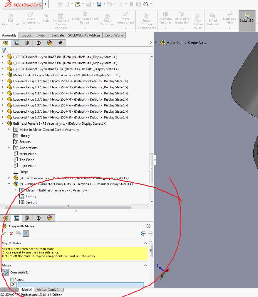

When I start "Copy with Mates" the CommandManager is split automatically into 2 panes, with "Copy with Mates" barely showing (I've attached a screenshot of what I mean)
After finishing "Copy with Mates" I can double-click the splitter bar to un-split the CommandManager.
However, the next time I do "Copy with Mates", the CommandManager splits again, and I have to repeat this process.
I tried checking "Lock CommandManager and toolbars" by right-clicking the ribbon and choosing "Customize", but this had no effect.
How can I prevent "Copy with Mates" from splitting the CommandManager?

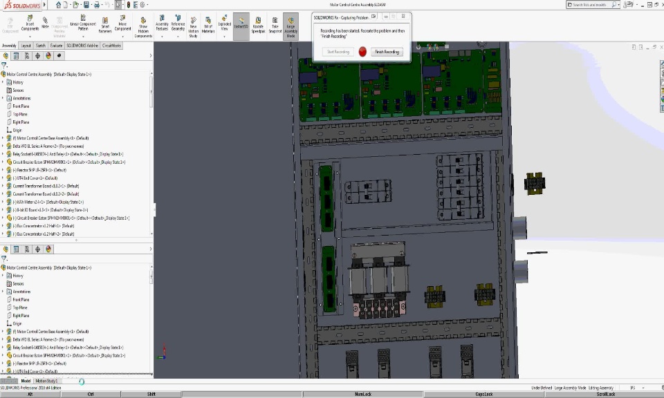

When I start SW the bar is already at the bottom. I tried dragging it up, then dragging it back to the bottom, before starting "Copy with Mates". Unfortunately the CommandManager was still split.
I have attached a video showing what I mean. Thanks for your reply!

The way it should work is if the splitter is at the top or bottom, the PropertyManager should take over the entire vertical space, completely hiding the FeatureManager tree. If the splitter is in the middle, there are two possible behaviors:
  1. If "Auto-size PropertyManager when panels are split" is ON, the PropertyManager will show in the bottom pane and move the splitter while the command is running to show the contents of the PropertyManager.
  2. If "Auto-size PropertyManager when panels are split" is OFF, the PropertyManager will show in the bottom pane and not move the splitter at all.
So it looks like you are getting behavior #1 even if your splitter is at the top or bottom which is not correct behavior.
Does this only happen on this assembly? If you open a new assembly file (with no components in it) and then run the Copy with Mates command, does the same thing happen? If so, where is the splitter bar on the new assembly?
If not, try one more thing; on the assembly that is giving you trouble, double click the splitter bar. This should automatically put it all the way at the top. Then try Copy with Mates. Does the same problem occur? If so, does the same problem occur with other commands like Insert Components or Mates?
Report back on what you find.

I tried a new assembly as you indicated. The splitter bar appears at the bottom. When I click "Copy with Mates" from ribbon, the dialog appears correctly in the top pane of the CommandManager.
When I went back to my working assembly (splitter also at bottom), I tried "Copy with Mates" from the ribbon and it works correctly as well! This is very interesting.
I didn't think to include this in my original post, but I usually invoke "Copy with Mates" by RMB on either the part itself, or on a part in the tree. It's only when I invoke "Copy with Mates" by RMB that the issue I'm seeing occurs.
If I double-click the splitter bar (or move it to the top), "Copy with mates" by RMB works correctly.
Next I tried turning "Auto-size PropertyManager when panels are split" OFF.
With the splitter bar at the bottom, I tried "Copy with Mates" by RMB again. The screen changes such that "Copy with Mates" is active, but the dialog is not visible because it appears on the lower pane, which is hidden/isn't auto-sized now.
"Insert Component" and "Mate" from the ribbon work correctly. "Mate" by RMB a part works the same as "Copy with Mates" by RMB above.

I have confirmed that if I have the splitter at the bottom and run Copy with Mates or Mate from the RMB, then it does indeed split, but running it from the CommandManager (our name for the ribbon), then it doesn't split. As a workaround, I would suggest opening your assembly template, dragging the splitter to the top, and resaving your assembly template. Then new assemblies will have the splitter at the top, not the bottom and you won't encounter this issue. On existing assemblies, you'll have to drag the splitter to the top.
Theoretically, I don't see why there should be a difference between invoking via the CommandManager vs. the RMB and consider it a bug, so if you would like to see it fixed, I would suggest submitting it to your reseller so they can get an SPR for it. For clarification, the "dialogs"  that appear on the left by default are called "PropertyManagers"; you had referred to it as "CommandManager", which again is our name for the tabbed toolbar interface for the buttons similar to what Microsoft calls the Ribbon. We don't call it the Ribbon for a couple of reasons; 1) we actually released this before Microsoft's ribbon existed so it already had the CommandManager name, 2) it does not work exactly like the MS ribbon since it is customizable, can be undocked or docked on the left or right, etc. I just wanted to clarify that so when reporting to your reseller, there isn't confusion over the terminology.
