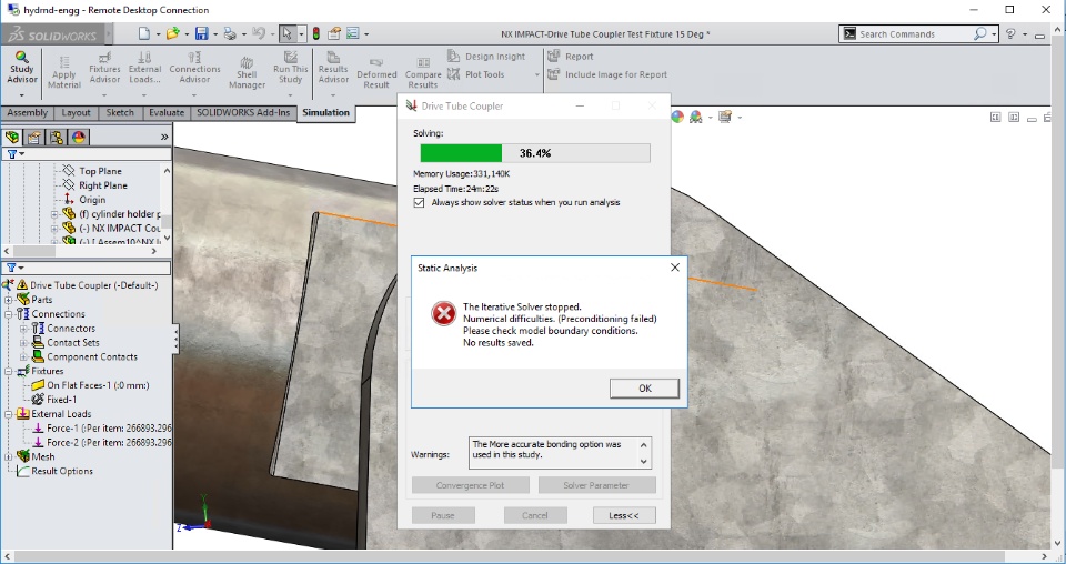

when i run simulation of assembly containing 25 parts with fixtures, contact sets and loads.
there is no problem while meshing but i get error of PRECONDITIONING FAILED CHECK THE BOUNDARY CONDITIONS .also i get popup saying use direct sparse solver. i am getting this error at 9.1%. Attached is the screenshot of that error

Then use direct sparse solver to see if it runs.
GA
GA 2016-10-17
its going till 100% and asking weather to use LARGE PROBLEM DIRECT SPARSE,when click on ok ...it is saying FAILED
GA
GA 2016-10-17
YES i did run with direct sparse ...its going till 100% and asking weather to use large problem direct solver...then i click on ok ...then it is showing FAILED
SK
SK 2016-10-17
can you upload your model here?

Hi Girish,
Assuming your model has no interference between parts, it is possible there are not enough restraints, i.e. one or some parts are not correctly fully restrained.
First you could check the correctness of the connectors (if any) between parts;
Then you could see if the mesh is congruent between parts (i.e. if the same nodes are shared between touching faces and edges).
Let me know if it helps.

i am able to do mesh without any problem...and.i used only bolt connectors

Hi Girish.
it is possible to have incompatible mesh between parts without errors from the system - in fact incompatible mesh is not a problem in itself, it just means that two parts are not merged when meshed. But this could make the analysis fail.
Have you tried to run the study with "use soft spring to stabilize model" checked in the study properties? This could help finding if there is something wrong in the constraints for some part.
Another trick to check your model could be creating another study, a frequency study, not a linear static one, with the same model. If such analysis is successful you can see from the deformed view if the model behaves correctly or if some parts moves "erratically".

Thank you all for your support. It got sorted...by constraining pin in one of the pin holder,by giving it a dumbell shape.so that the pin doesn't go away when load is applied.
