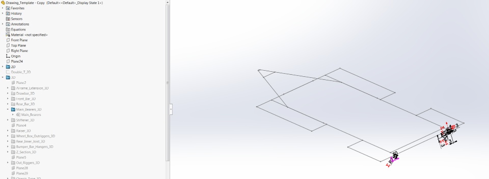

Hi Team,
I have an issue when I try to edit a sketch of one of the 3D extrusions, that all the previous Solid bodies and extrusions disappear. What makes it even stranger is that it only happens when I open edit sketch on one particular extrusion.
When I edit sketch in this extrusion, all preceding bodies remain
When I do it on this extrusion, all disappear
Does anyone know what could be causing this?
