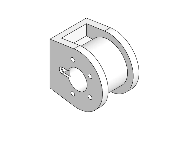

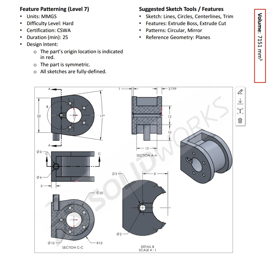

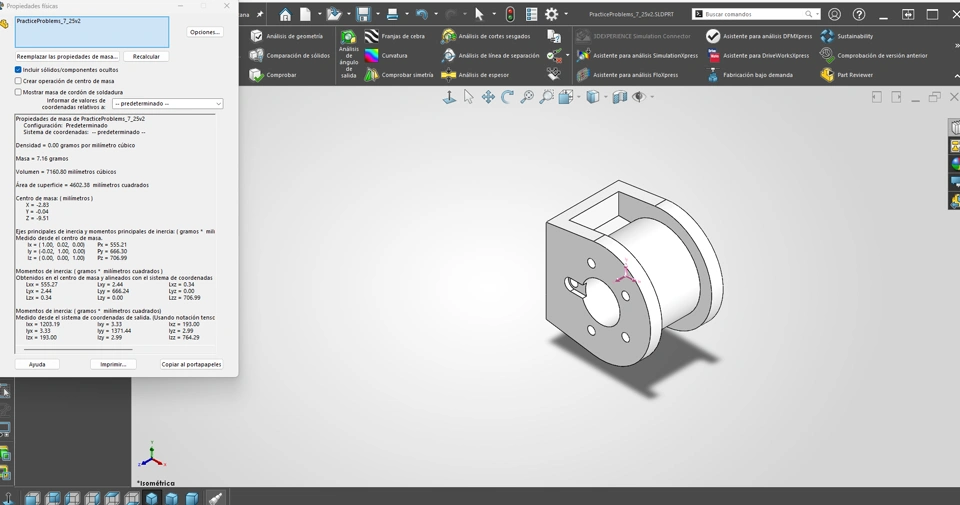

I would like to compare the result with other users, since there is a small difference between my result and the one in the PDF.

Detail on right side is missing. just mirror it and answer would match.
