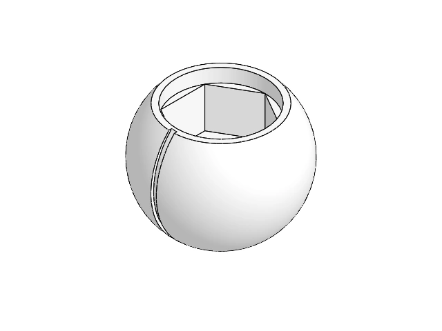

Practice 6.14 CSWA Non-Centric Hexagon

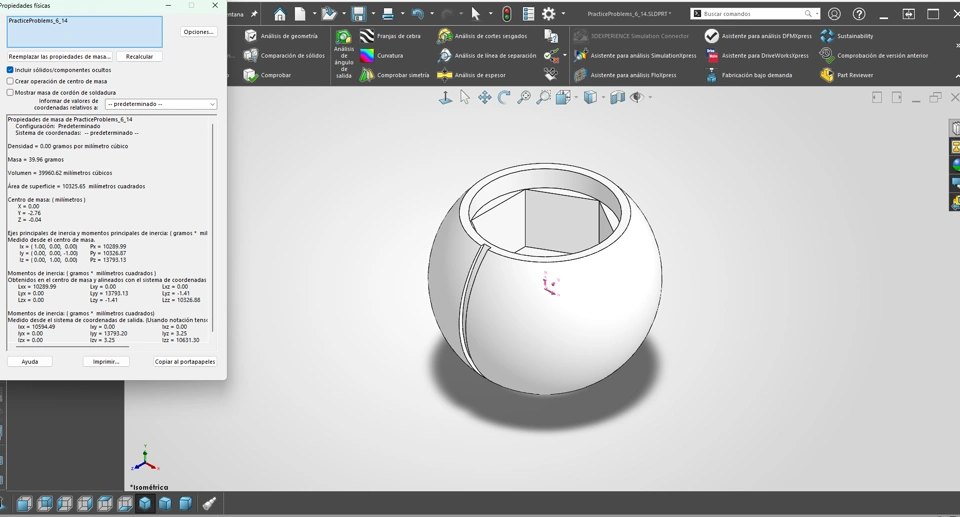

The volume error is very small. I've noticed that, for some reason, even though the hexagon is concentric, it doesn't cut equally along the circumference. I don't know what could be causing this, and it's possible that this is why it has that small volume error. What do you think?
Answers 2
SD
SD 2026-02-24
Image Quality in your Settings may be affecting this.  The higher the image quality the better circles are displayed but also the larger the file size.  This affects display only not the actual part.  See the difference in the two images.

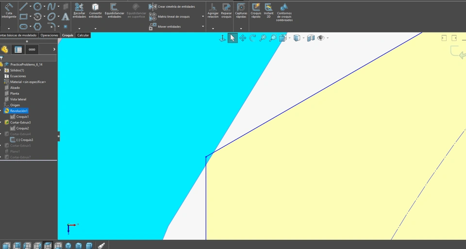

For the first cut, you need only to have offset 2mm the circular edge and there'd be only one contour, not your two, which can lead to an error condition.
Your hex cut sketch isn't fully defined, so the hex can be resized.
If this hex is to run to the ID of the previous cut, relate any of the hex's tip points coincident to the ID edge of the previous cut.
I get the same volume, but the hex sketch is now fully defined.
