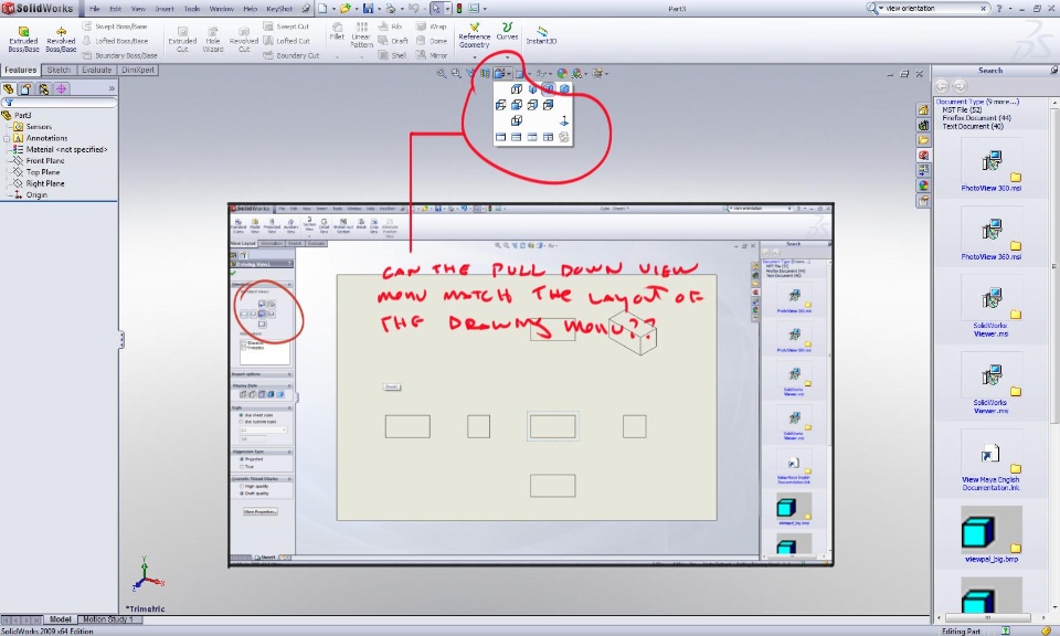

Is it possible to match the pull down view menu of a part to the same standard as the drawing view?
I have drawing doc as 3rd angle and the back view of the side is the first view on the left side. I am teaching a basic drafting class and want to have these views be consistant.

To answer your question, No, the View layout in the Heads-up Toolbar cannot be changed.
IMO, the View layout shown in the Heads-up Toolbar is a depiction of the sides of an actual solid part, and correctly shows the real-world location of the faces. It is, and should be, independent of whichever drawing projection standard is being used. The two viewing functions are not the same.

The drawing view also shows also shows the the part as a depiction of the solid part (like the heads up tool bar). The only difference is that the back side is in a different location on the 2 menus. I'm not sure which is the standard. I know I will get the question where the back view is ( next to the left side view or next to the right side view). I'd just like it to be consistant when showing orthographic views.
The location of the ISO part changes (on the drawing menu) when you change from 1st angle to 3rd angle.

I don't know if that is specified in any drawing standard.
